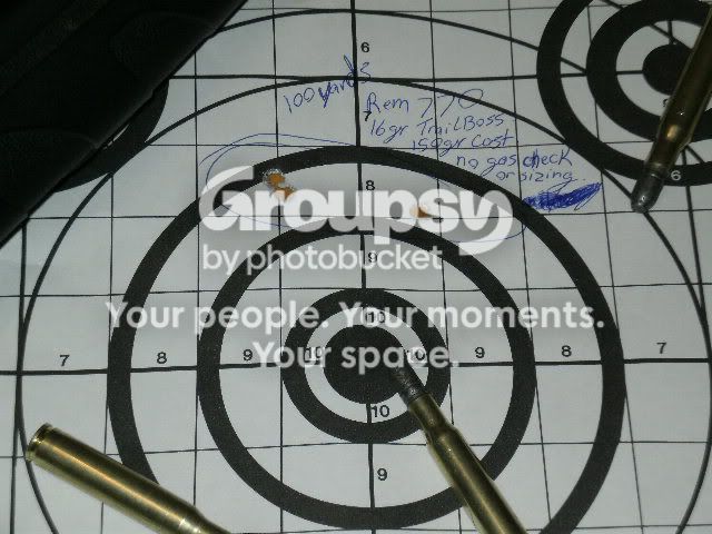

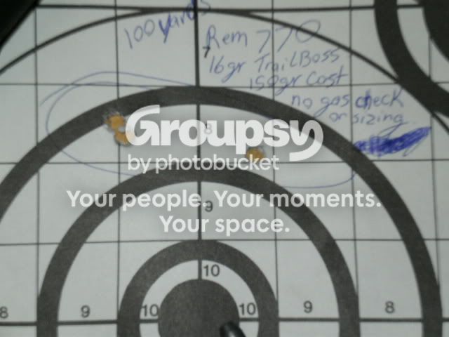

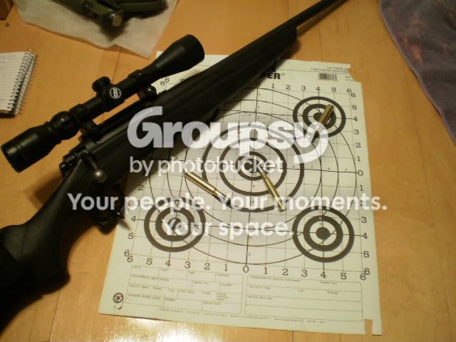

ok as promised i got a target with a 3 shot group i did today. the taget was shot at 100 yards, no scope adjustment,holding at dead center of target with a front sandbag as rest. the one flyer was my fault do to pulling the trigger.
i used my rem 770(main gun for now) overall for my first cast boolits i have ever shot i must say i am very very happy with the results. once my sizing die and gas checks arrive i will be posting some on the EE for sale.
