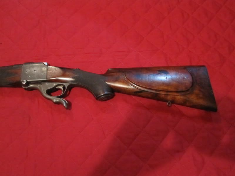

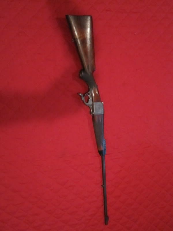

Hello All,
I am the proud new owner of a fine old Farquharson rifle marked "J Burrow Maker 116 Fishergate Preston" It is chambered in 375 flanged Nitro Express 2 1/2, has tang safety, Krupp steel barrel.

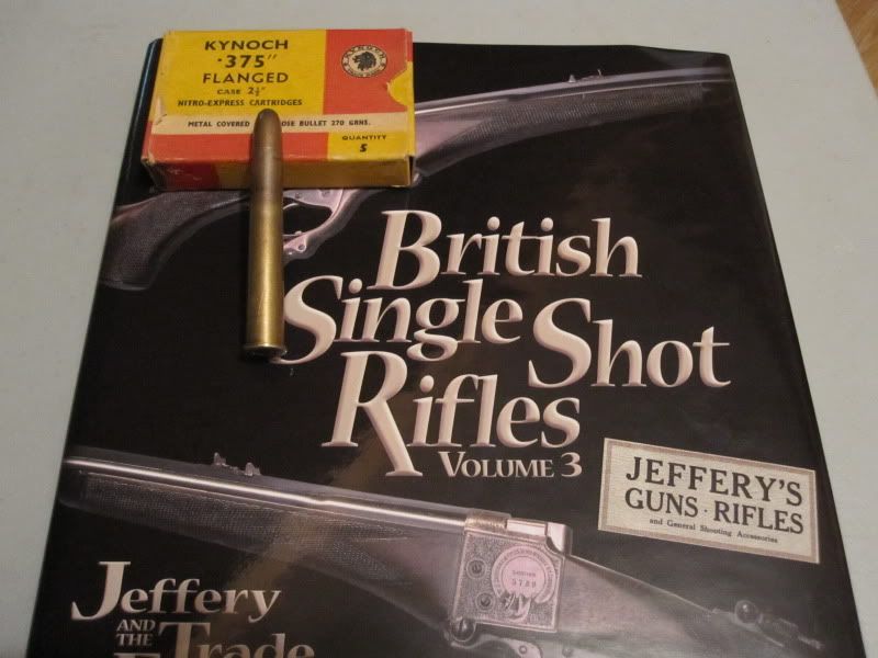

I have ordered "British Single Shot Rifles v3" but I'm an impatient fella.....
What can you tell me?
Thanks
Mark
If that thing could talk, I wonder what tales it could tell! As quality rifles go, yours is very near the top of the heap. What are your plans, going to shoot it and hunt with it? They say the flanged .375 can be loaded to almost the same level as the .375 H&H, but I would be more inclined to load a 270 gr bullet to 2500 with H 4350 and call that just about right.

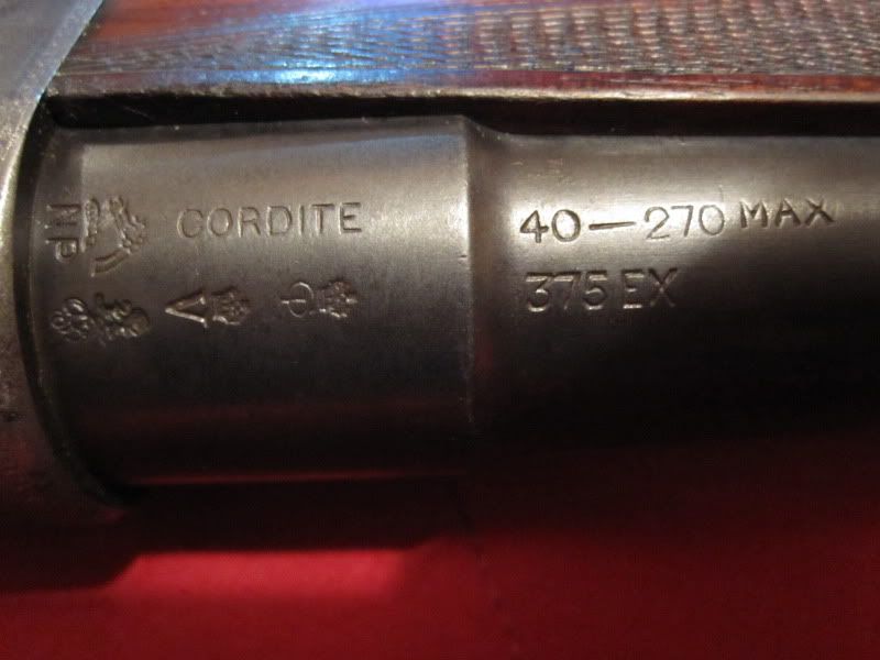

Nice rifle. That cartridge is NOT a belted 375 H&H. It is rimmed straight case which utilised a 270 grain bullet at around 2000 fps. and is so proofed on the barrel. 40 grains cordite, 270 grain MAX. You can duplicate this by using Seyfreids Reloader 15 conversion of Cordite charge (40) multiplied by 1.19 = CHARGE OF Reloader 15. I've done it on a 9.5 mm Mannlicher( which the Brits call the 375 rimless NE ) stamped Cordite 43 -270 Max and it works out quite well - chronoed velocity wise. stay away from "fancy" bullets. IF you can find em, plain old Hornady round nose will work just fine. cheers

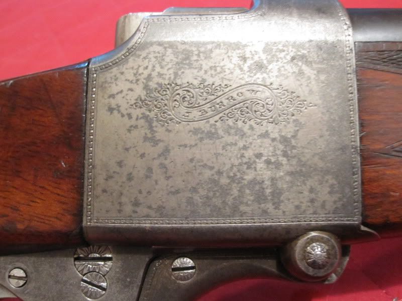

Here we go, ..
James Burrow, s.a. 1833-41, 116 Fishergate, 1854-c.1913, then as (most likely a son) c. James Burrow Ltd., 117 Fishergate, c.1917
No records.
from British Gunmakers - Vol. 2, Birmingham
Without the name, I'd put it as a Jeffrey, so it was most likely purchased for the buyer assembled and they put their name on it prior to selling. Common enough occurance!
Can't find any other reference in the library.
