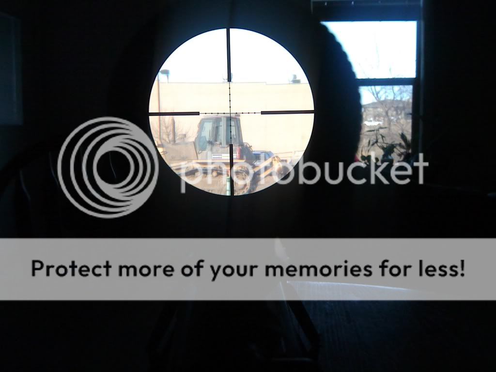

Here it is zeroed out

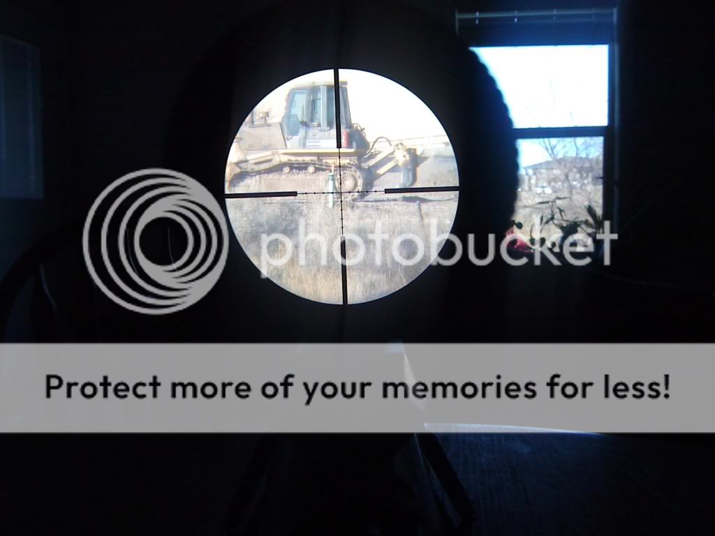

Here is the total adjustment used for shooting 500 yards with the .22lr

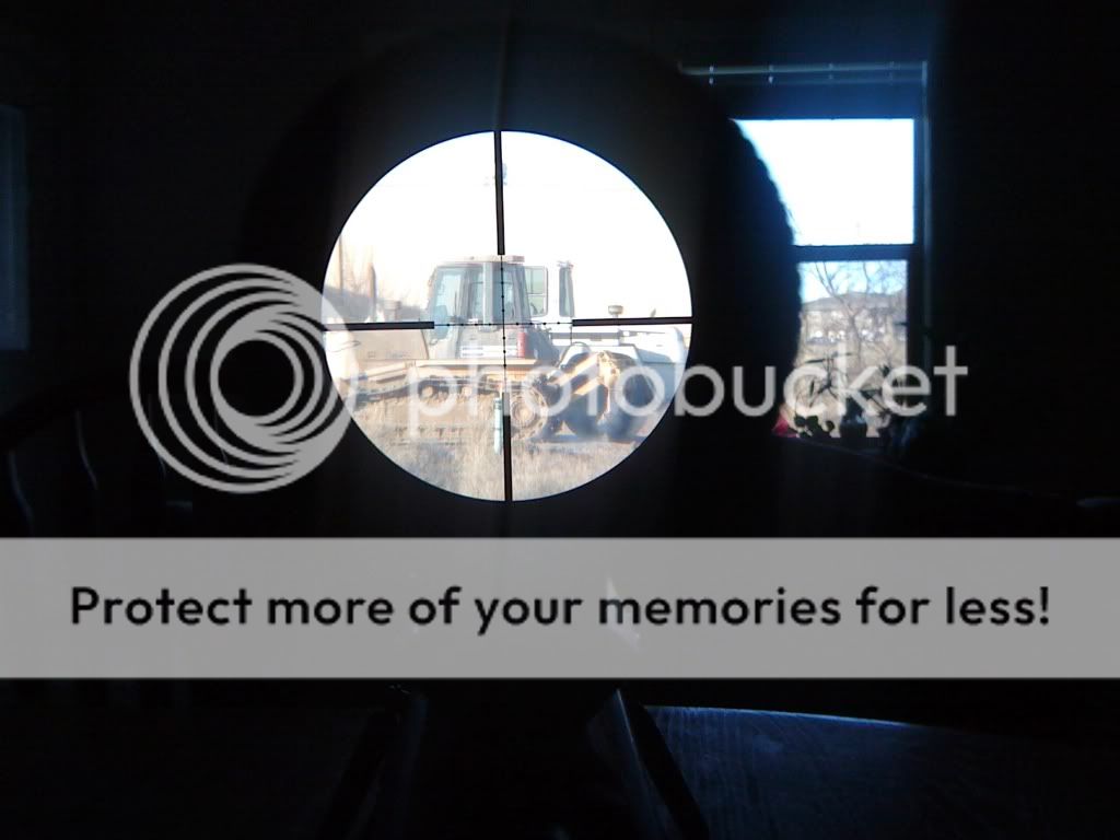

reference Picture, 1 mil= 2 mil

Pic 1 is where my 50 yard zero is
Pic 2 is where my 500 yard zero is with the gun not moved.
Mils are correct at 12x but i have it on 6x to get more of it in view
So what i am trying to figure out is how much that movement is to see how much drop it takes to shoot 500 yards.

If you know the point of aim drop is 108", then just divide 120 into 500 and mutiply that by 108. I get 450", or 37.5'.
What you don't seem to have is a target of known height. Go measure from the top of the cab to the bottom of that hub. Just before dark might be the best time. :)
