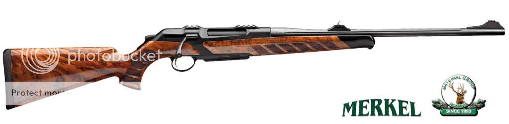

This is a merkel helix reciever:
Take a look at it and imagine a gear on the bolt handle going on these teeth. There is a 2:1 ration, such that the length of the bolt travel is a half of the bolt travel. The fallout of this is that the force on the bolt handle needs to be greater. In case of the stuck or stubborn feed it will be harder for you to apply additional pressure. The condition of the teeth and gear will greatly influence the feel of the action, people said that new helixes have different feel from rifle to rifle.
