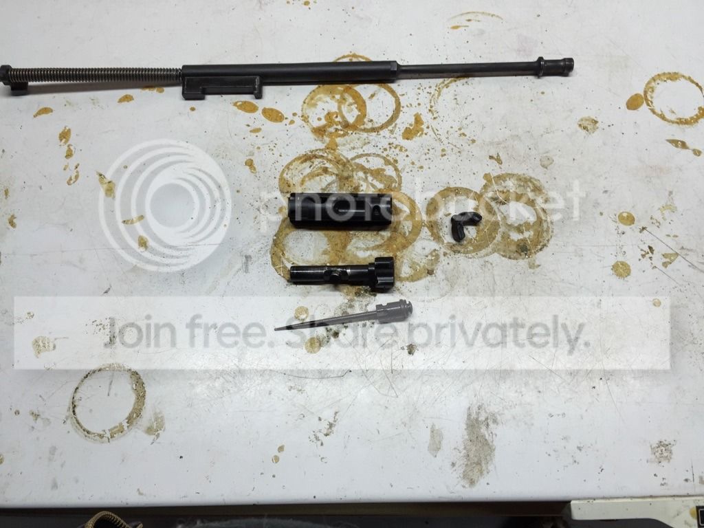

I'm having some teething problems though. I had almost finished my session when the gun bunged up and wouldn't cycle properly. As near as I can tell - that rubber buffer thing on the back of the bolt might have come out. I'm not sure of this but I took the gun apart, reassembled it...and it seems to be working now. Does that make sense to any of you old hands?

They are great rifles, Wolverine Supplies has the parts you'll need. You also will need to know what version of the rife you have to know if they're Type 1 or Type 2 parts (you have type 2). I would recommend spare firing pins, buffers and retaining pins maybe recoil spring. Also maybe a gas block, incase you forget to set it correctly (after cleaning / disassembly) and end up ejecting it downrange after changing gas settings ... So vary few small parts / low cost. Major issues would be piston or bolt cracking (very rare now).
Get a couple extracter "springs" and a spare extractor or two for sure.
And a spare ejector may come in handy. If it wears down over time it could cause a lot of problems with the feeding/cycling of the gun. Cheap insurane to have one at hand.
Maybe a spare operating rod but that's going to start getting pricey.
The extractor "Spring" isn't really a spring, it's piece of cyclindrical rubber! I bought one second hand off the EE, buddy selling was full of s**t and said it worked fine. First trip out was FTE after FTE etc
The rubber dong can weaken if you use strong cleaners/solvents to clean your rifle. I'm 99% this was the case. It even looked like buddy took it apart to mess with it to get it to work. Anyhow, I swapped the spring and the xtractor ($25 in parts) and the thing would eat anything I could put through. Soft Point, FMJ, OT anything!
After that I don't think I ever had a single stoppage with it after over 1K rounds. All on gas setting one. Casings were flying 20 feet!
Not very accurate with irons because of the stubby short sight radius on the older models but it is indeed a very well designed and well built gun. Lots of fun to shoot.
Gas problems can also arise when the bolt holding in your gas block gets loose, keep it tight or it wont cycle right.
