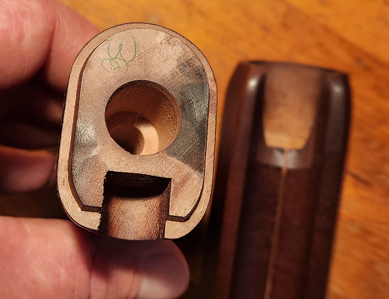

Have a look at this picture .... the outer surface should not be mating with the receiver and to prevent splitting ... the stock is cut that way.
However, nobody was able to confirm so far if the Fieldmasters have the mating wood surface varnished or if it is bare wood?
If it is bare wood, I would take the stock and give it a good varnish inside and out. Otherwise, water will get in there .... the wood will swell up .... and then shrink again .... and the finish will come off in blisters.
This is the bare wood mating surface of a Tac-14 hardwood stock.

The gap is supposed to be there. There is a recoil bearing plate between the stock and receiver to prevent cracking. This is only needed with wood stocks. The bearing surface of the stock will be sealed.

madtrapper nailed it, wood stocks have the gap due to the bearing plate to avoid cracked stocks. Synthetic 870 stocks don’t use the plate and are more of a flush fit.

That space is there by design. Every 870, 58, 11-87,1100 etc has this space so recoil does not split away the outside edges of the stock over time. If you remove the stock you will see a thin steel spacer between the wood and receiver to provide a larger contact surface for the recoiling receiver to bear on the wood.
