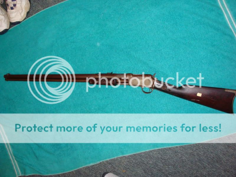

Hi Dave
I've a Lightning in 38-40 that I shoot occationally. Second year of production. Sights not original, but period. Wood needs a bit of work yet & have new stock & foregrip yet to fit (winter project). Replaced some internal bits & now she is slick as pup#### on a vinyl floor. Fire away with any questions & I'll help if I can. Pic of the old girl below...
