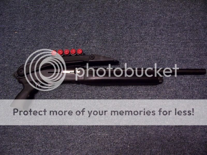

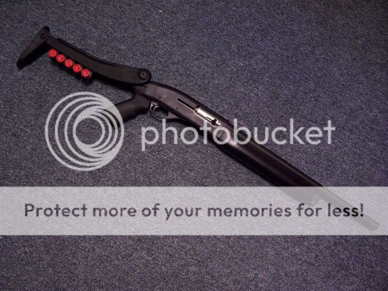

I actually did the same thing that you are thinking about doing. With a Remington 878 Automaster. I cut the barrel with a pipe cutter that a plumber would use to make sure i go a nice even cut. And i took about 6 inches off the end leaving it just over 18.5 inches.
And since most shotguns are centrefire then 18.5" is the legal min for the barrels. :D
