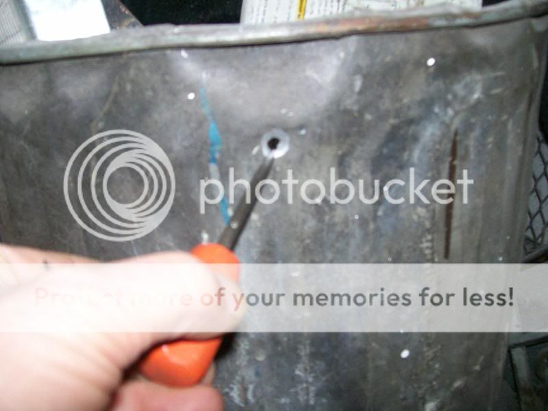

No, I just modify the ones I have......putting heavy duty springs in. I got a 177 rifle that will fly through 3/4 plywood.
this is at 20feet. front
rear
before the up-grade, the pellets would just burry them selves.

Its 1230 feet per second. If I "diesel " it, it will go 1520 fps. lots of people don't agree with dieseling but I have heavy duty piston rubbers that can withstand even more . Its as loud as a 22cal rifle. You do need a well built rifle before you attempt this. I had to build a "jig" to re-assemble the gun because of the massive spring pressure. It will go through a standard spruce 2x4. The bullet drop "pellet" is the same as a 22rf @ 100 yards.
the rifle Crosman Optimus .177
phone book
the plywood
metal
