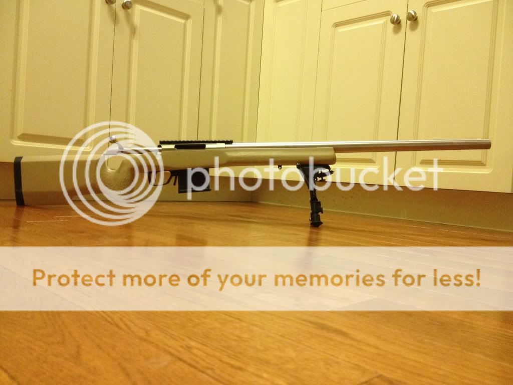

I have a T3 action with a Shillen barrel in a Manners T4 stock with a CDI bottom metal and I like it a lot. No real work was done to the action, the parts were put together and it shoots 1/2 MOA. The bottom metal just makes it look cool. I haven't even bothered to bed the action to the stock. The T3 action is pretty flat on the bottom and the fit is quite snug so with mine only being a mild recoiling .223 I just couldn't be bothered since it shoots great as is.
That's exactly the type of build I'm thinking about!
Would you be willing to share some pictures so I could get an idea of what that looks like all put together?

Thanks Tikka223, that looks awesome. The Tikka's have such clean lines in my opinion.
How do you like the CDI bottom metal?

Barrel pretty much has a 1" contour barrel the whole length, 26" total. The CDI is very nice but be warned that you will either have to file down the outer sides of the AI mag's feed lips or you will have to file down the inside of your action to make it fit. Filing the mag was quick and easy and I don't think it weakened the mag at all.
