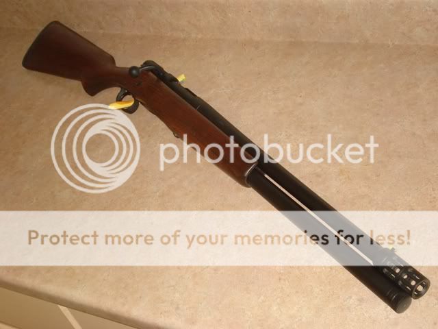

OK, here's an odd duck that we built and haven't figured out what to do with yet. Its a JC Higgins 583.20 bolt-action 12ga.
Work done:
Repaired and refinished the stock
Added a Pachmayr Decelerator buttpad
Shortened the barrel
Added KA-1212 brake/suppressor
Added HiViz fiberoptic sight
Installed a modified Moss500A magazine tube for 8rd capacity
Added Wolff extra-strength mag spring
Added S&J magazine follower
Sandblasted and parkerized all metal parts
Duracoated gun in "KA Black"
That's about as much work as you can do on a $75 gun ;)
That gun was just a result of boredom and some loose $$$ to spend on stupidity. Probably won't ever built anything that ridiculous again but it was fun.
