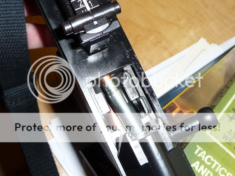

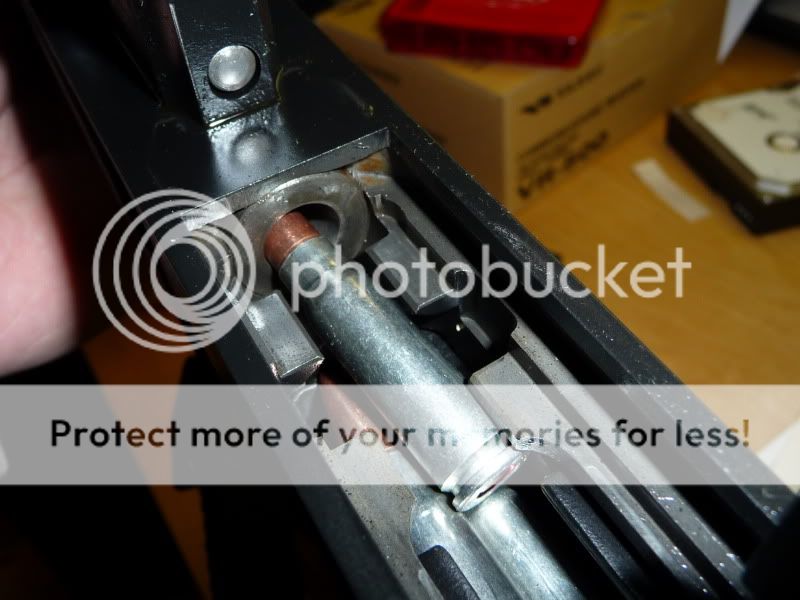

Sorry for the non descriptive choice of words, I guess a picture is worth a thousand words
First pic is just after I pull the bolt to the rear and release
Second and third pic are with the bolt locked back again, and the round is "jammed" (sorry don't know a better word). I can not get it to go forwards or backwards or back into the magazine. Once I release the magazine, the "jammed" round drops free.
Was the carbine brand new? Is the chamber clear of obstructions?
It looks pretty dry, have you lubed the receiver rails and bolt carrier?
Edit: from about 3:40 in the video below you can see how it's supposed to feed. Your looks likes it getting most of the way there.

Thanks to everyone for the help, but I found the problem.
There is a large burr (here come the undescriptive words) under the rear right rail, the one near the lip of the round in the pictures. Took two seconds to remove it, now the rounds chamber perfectly. I wish I had looked closer when I was at the range.
