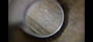

G griffin86 CGN Ultra frequent flyer Rating - 100% 68 0 0 Location Saskatchewan Apr 3, 2026 #1 Guy had a couple Cooey 60s that were caught in a house fire. They saved them before they burnt. I was sandblasting it and noticed the crack. I bore scoped it an it looked rotten inside where the crack is. Attachments IMG_3450.jpeg 127.6 KB · Views: 56 IMG_3453.png 234.8 KB · Views: 56
T tiriaq Super Moderator Moderating Team Rating - 100% 252 0 0 Apr 3, 2026 #2 I've seen a Cooey 60 barrel with a piece blown out. Fired with an obstruction.
M Meroh CGN Ultra frequent flyer Rating - 100% 62 0 0 Apr 3, 2026 #3 I have seen that, also on a hamilton rifle. I think it is a barrel that the tube is forge welded. ####ty way to make a barrel IMO.
