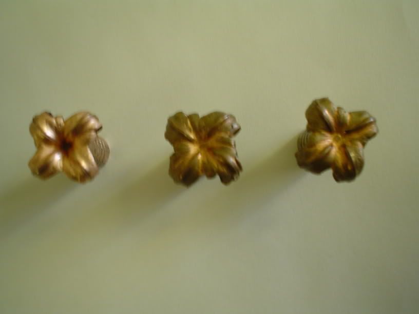

Here are a few I've recovered (all still weigh 225gr).
Left to right:
1. Whitetail Buck 27" Penetration (broke rear hip and travelled down spine) on a Texas Heart Shot @ 150yds.
2. Black bear, double lung shot and exit (found bullet in the bank behind the bear).
3. Block of wood (Test)
They expanded well, and internal damage was considerable. I took another good blackie at close range... bullet might still be going for all I know!
