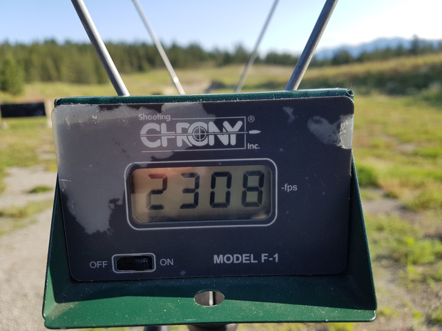

My old marlin 336 likes 36.0 grains of leverevolution. Put first 3 into half inch at 100 yards. Fourth shot opened it up to just under an inch and was getting 2300fps on my chronograph. I set up water jugs at 100 yards to see how well they expanded and did pretty good. Brobee has an elk hunting video on YouTube and he tests different 30-30 bullets, including the tsx, that’s worth watching
I've actually obtained over 2300 FPS with my 1941 Winchester 94 with a 170 grain bullet using 37 grains of LeveRevolution, with no excessive pressure signs.

According to their online data published on their website, the max is 36gr LVR for 2300 FPS from a 24" barrel. The second fastest is 2187 or so, and they descend from there.
