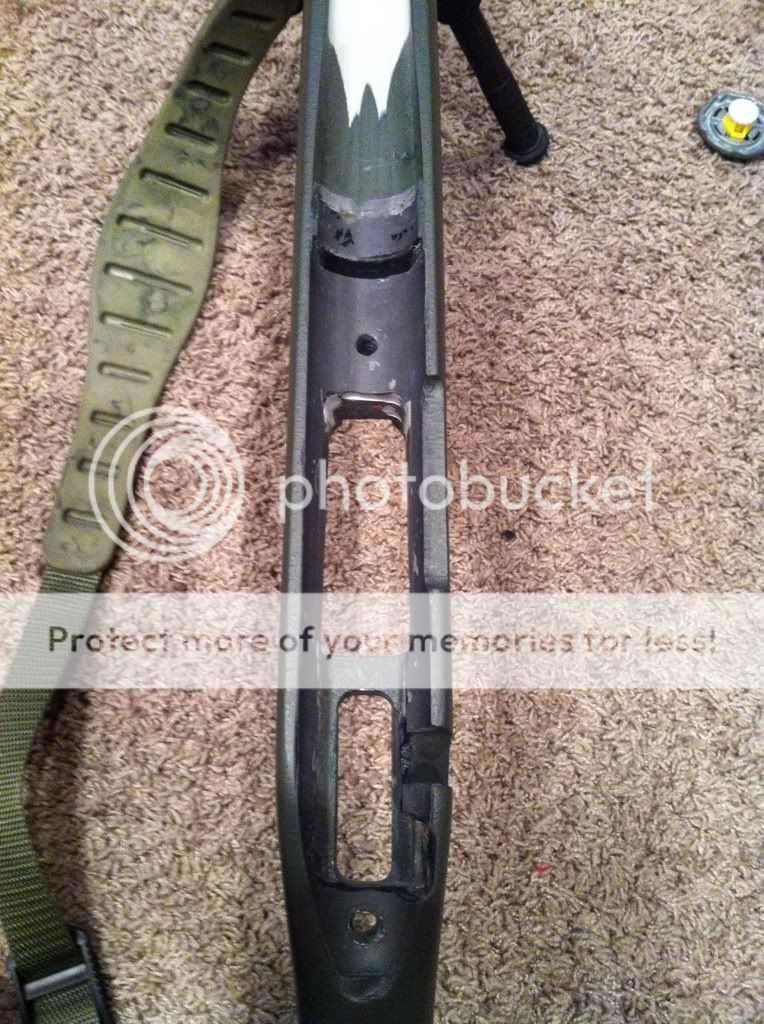

Bit the bullet and bedded the rifle tonight. Used Devon steel putty and kiwi neutral shoe polish for release agent. Followed the instructiOns from snipers hide.
Turned out great. My one mistake was not wiping off the excess filler that squished out around the stock or trimmIng it before it got too hard. That meant alot of careful dremel and file work to blend the devcon around the top edges. I used green painters tape on the entire stock and rubbed kiwi neutral shoe polish into the tape. I put that everywhere I didn't want the bedding compound to end up. I also used play dough to fill in the mag hole in the stock and all of the holes and slots in the action. I bedded 3/4 inch in front of the lug. I figure I can relieve it if I want to try it fully free floated. Again I followed the instructions from snipers hide gunsmithing section. I will put up a picture of the finished product tomorrow. Since the stock is a McMillan edge and the fill is white it does not look very pretty were I dremeled out the putty back to the mag and trigger well slots, but that is all hidden when the gun is together. I did wear a mask while grinding since the edge fill contains carbon

Good on ya for moving out of your comfort zone and then bedding it! I recommend newbies practice their bedding skills on various sub $ 100 .22LR Cooey or other cheap .22LR rifle. Nice and easy that way, less intimidating and you always improve that Cooey's ability to group! :D
Yes release agents like neutral shoe polish, PAM (cooking spray) are your friends. I like paste wax for a release agent. I just leave it on the underside of my Rem M700 to repel water. Life is good!

here is the finished product, just need to wipe out a bit more of the playdough. I had sanded in the barrel channel and removed the epoxy layer and exposed the edge fill you see in white. Should it be re-sealed (painted) or is it impervious to moisture etc?
