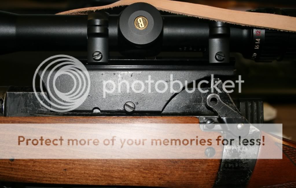

I have one like Beaters. I bought it from a member here, but he didn't make it. Just a piece of angle iron but built with precision and strong. Works great.

yes I have. it is easy and stupid strong
Aside from looking like exactly what it is. It is the best Lee Enfield mount around. The mount is crazy strong. I have no regrets.
