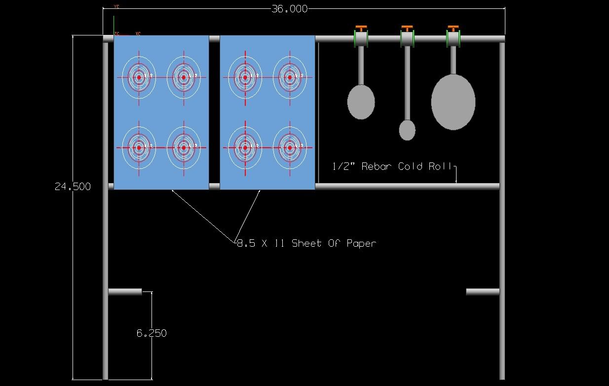

I am about to make my own target stand. I didn't know if there was anyone out there with some good ideas for me or pictures of what they have been using.
Here is a picture of one I designed today.
Good idea. How are you going to put the paper on though? Maybe if you were to put some pieces of plywood on the metal and then staple the targets to the wood that would work. And then replace the wood when it gets shot out.
if you can find a DISCARDED real estate ''for sale''sign,they work pretty good-the metal kind that you push into the ground.A stiff cardboard back board can be easily attached onto the rail with zip locks ties ,and then the targets stapled directly onto that.Simple enough to weld up a frame out of rebar too

Currently I use one of them heavy cardboard fruit boxes from a local store, and
stick targets and post-its, etc to.
Yours is way nicer than what I make, I take a piece of plywood, OSB and 6 chunks of 2x4, 2 are 16" or so and 4 are 6" or so.

Basically the two shorter pieces are screwed to the longer board so that they wedge the plywood so that it stands up but it is easy to pull out an lay flat for storage. combine that with a foldeing shooting bench and a range is anywhere you have space.
Made one of wood but it was pretty ghetto.
Im in the process of making a big universal one. With steel clays and parper slots..
ill post a pic when its done.
