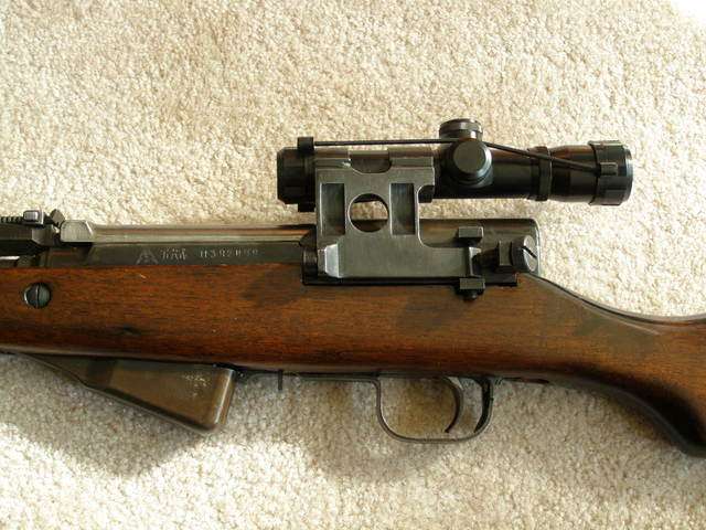

Just to clarify a few things. PU mount as in 91/30 sniper mount and scope.
now on SKS
(sorry but I had to steal images from an other forum)
I know it can be done, and what methods people have used. I am simply asking for experiences in detail, of which most threads lack. Proper base width from receiver to keep the rings bore centered. Proper height so it's still possible to use the irons... etc.

Mounting a PU on a SKS would be simpler than a Mosin. Just get it straight to the receiver and shim it out or grind/file/mill it in to center the bore. From that picture it would be easy to calculate measurements. You can mod the SKS ejection port to make cases come out sideways so clearing any scope is no problem.
I have a PU Mosin Sniper and yes, eye relief is short. You'll need to get your face up close to that PU scope. Understandably with a bolt action sniper with one shot then slink away back into hiding, but not practical with a semi for rapid shot follow ups. A modern scope with better eye relief would be faster and more enjoyable. I'd get a PU mount with 1" scope rings like the picture shows. That mount looks a lot lower than an original PU mount.
