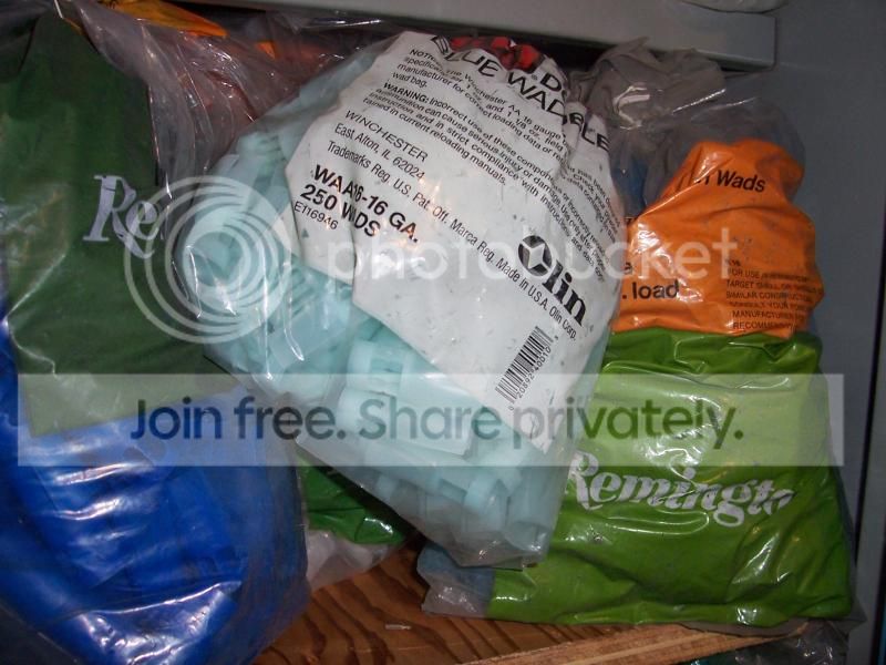

Mainly old school however win 209 primers, unique powder and original win blue AA wads and some vintage long forgot rem ones
