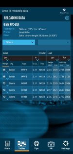

This might get you close enough to start.

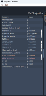

So GRT doesn't have the 64gr. It has the 62gr and a 65gr. I ran both just to get an idea. Not sure it helps but its what I had available to me. If you wanted to provide the data requested in the last photo I could input the projectile.
