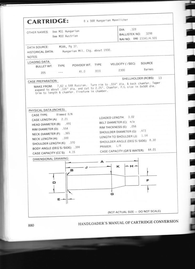

i'm looking for the brass....where are you getting or finding it ????....I can't find anyone that has or knows of someone selling.....
Tradex lists it, but shows "out of stock".
Brass can be made from 7.62x54. I can't remember the exact procedure, but I'm sure a google search would turn up something.

Here's a quick scan from my cartridge conversion book
