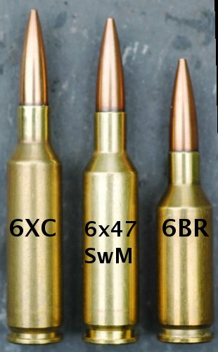

I have a rifle chambered in 6X47SM that I did up because I had a bunch of RUAG brass given to me by a friend from Germany and it was the one of the only 6mm cartridges I had never tried It is very similar to the XC, but the brass is the only stuff to rival Lapua out of the box for quality and consistency. I have played with 6-6.5X47 Lapuas and they were a fussy round for me. Gave up. I have also played with the 6-22-250 which was pretty good (Might go back now with Lapua brass) . The XC is the closest to the 6x47 Swiss for ease of use, but you need (not sure if you still do) to buy dies from Tubb. Combination of a great barrel for me, good brass and an easy load to make work, and being a bit different makes this my favorite 6mm cartridge. Try VV N550 and start at about 36 grains with a 105 hybrid and go up from there. It is like a 6BR on steroids.
