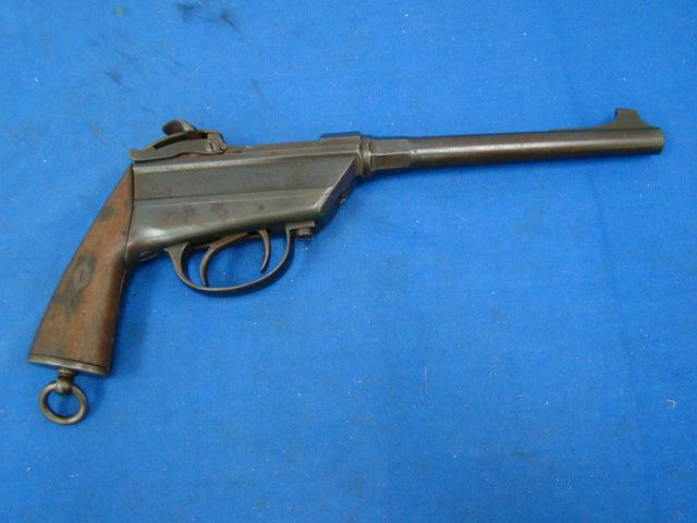

I just got a very cool BIG single shot pistol a Weder M 1869 .

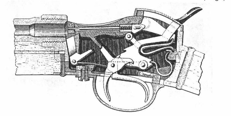

This is the workings of the rifle- could not find (or look long enough) for pistol.
(I understand that the inner workings are the same.)
This is the pistol. ( not Dingus's specifically - you understand.)
This pistol is so ugly that it is beautiful. You are lucky Dingus.
