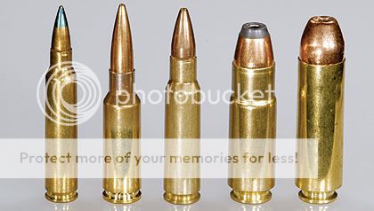

Problem is the case head size. This is a problem that has plagued AR15 conversions to these larger cases. My understanding is the reg 223 bolt head may get too weak when the bolt face is opened to 0.473".
The ejector is in the wrong place. The extractor would need a rebuild too.

for the sake of arguing, 5.56 on the far left, .458 SOCOM second from the far right, you can get an idea how fat the arse of the brass is in the pic.
