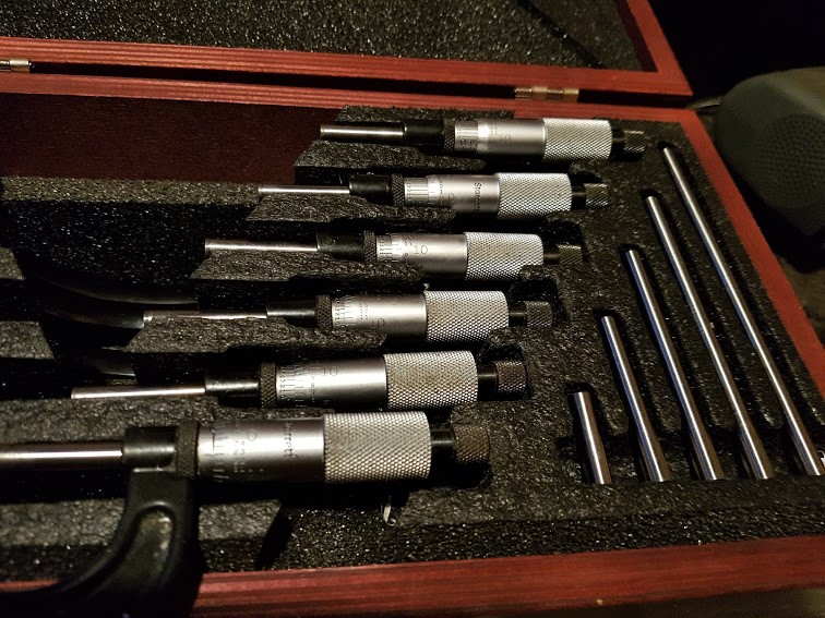

My micrometer set came with standards 1-6". When I am doing anything I want to be closer than 0.005" I will use them to check whatever instrument I am using. That's a little above and beyond but it's a hobby to me. If I used the stuff every day I might not be so tedious about it.
