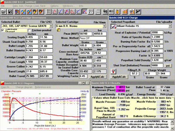

QuickLOAD is an internal ballistics predictor computer program for firearms. And it has charts and graphs showing the pressure and velocity curves.
All the information is ballpark and you need a chronograph and tweak the powder burn rate until the velocity matches your chronograph. When this is done you will get more accurate chamber pressure readings.
The image below in the bottom left shows the pressure and velocity curve and the percent of powder burned. Example with Titegroup and a five inch barrel .44 magnum 100% of the powder is burned in less than three inches. "BUT" if you switch to 296 or H110 you will not get 100% burn even with a 20 inch barrel.
Quickload gives you more ballpark information than a reload manual, but even with a chronograph the chamber pressure readings are just computer generated guesstimates.
The good point of Quickload is showing the most efficient powders for a given barrel length. But the Speer manual gives short barrel loads and is far cheaper than buying Quickload and a chronograph.
