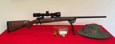

Here’s my latest sight-in check at 100 yards, yesterday afternoon.
PRVI 286 gr ahead of 58 gr of CF 8506 and CCI 200 primers . Adjusted scope up three inches and right three quarters of an inch.
Ready for anything we have here with dead-on hold to 200 yards.
