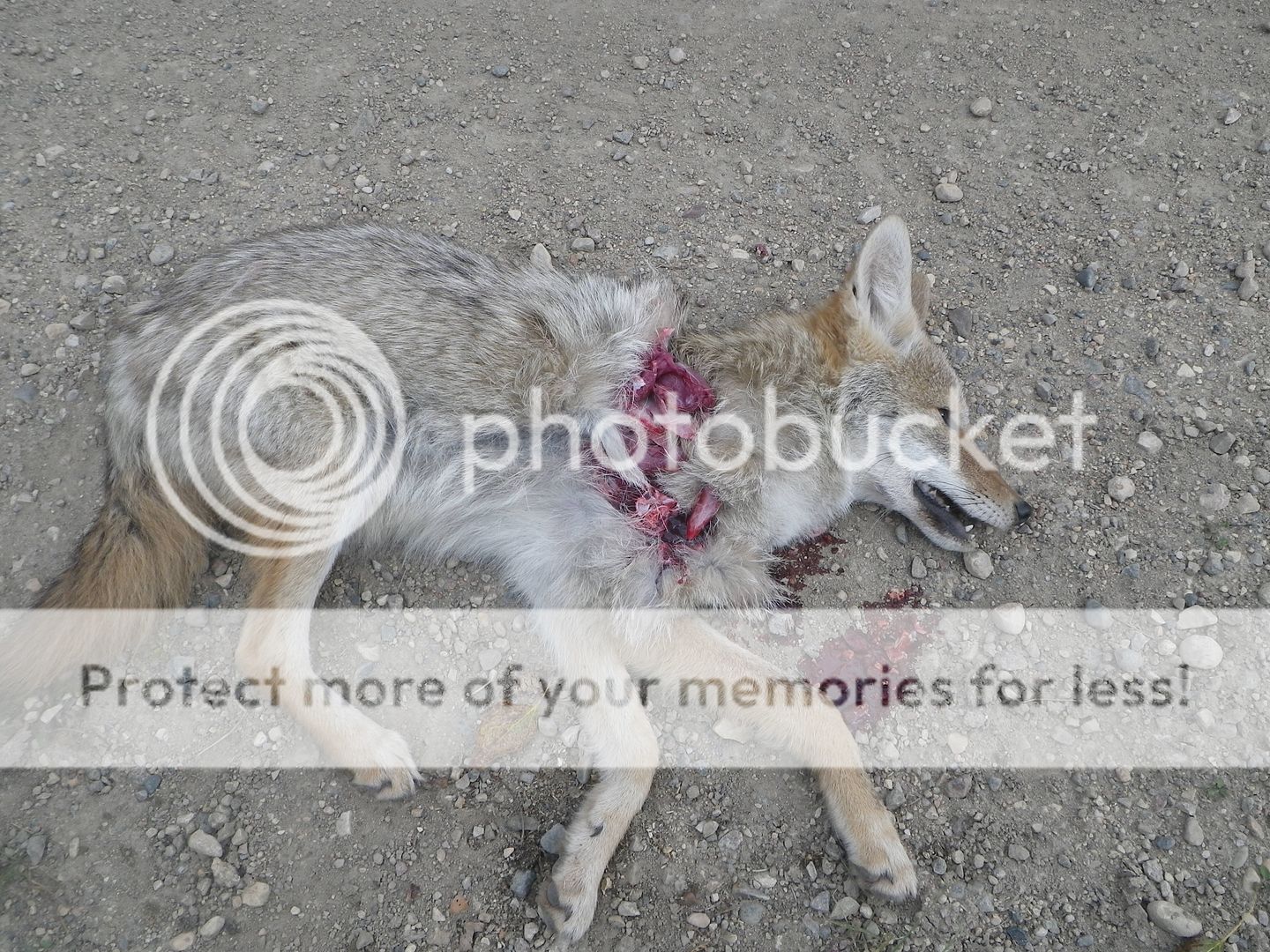

Neither of those will be pelt friendly. Try a Barnes TSX. I've shot quite a few coyotes and wolves with a 100 gr out of my 257 and they often do little damage, especially on frontal entry when the bullet travels through the internals and exits out the ass. If you hit the spine or a leg bone on a broadside shot (like Dogleg's picture), there aren't many calibers out there that won't damage a coyote pelt, other than maybe a 17 HMR and the like.

With coyote, it seems to be very dependent on where you hit them. I've blown huge holes with 223 FMJ and had a 300 WM pencil through. In any case, the 270 WSM won't be overly pelt friendly regardless of where you hit them, but if your objective is to kill, it makes a fine round. Fur prices on coyote have dropped considerably anyhow.
This one was shot with a 257 Wby and 85 gr. Nosler Ballistic Tips doing 3800+ fps. I was actually amazed at how little damage that round did in this instance, but I know full well that the next one could be torn in half too.
