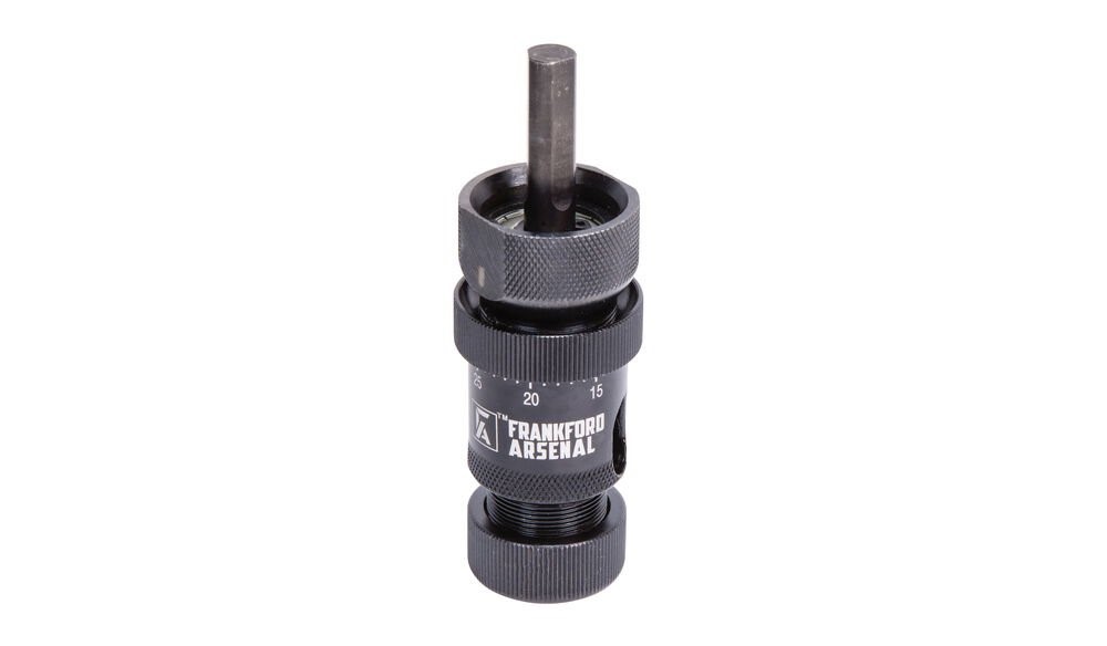

Just came across the Frankford Arsenal Universal Precision Case Trimmer, and I'm looking for opinions from others.
https://www.hirschprecision.com/index.php?main_page=product_info&cPath=100_305&products_id=4801
Anyone try this? What did you think? Is it faster and/or easier than using Lee case length gauges and cutter?
It looks like setting it up takes a bit of time compared to the Lee system, but once its dialed in you can rip through cases real fast.
Thanks!
I have one… try using it, unfortunately I can’t seem to be able to make it consistent, I tried a bunch of things and there is always quite a bit of variation in the trimmed brass! I wouldn’t buy an other one that is for sure!
I have had the same problem, I use mine mostly for chamfering and primer pocket cleaning.
I use a Dillon for trimming.
I feel like you might be referencing a different product? This isn't the case prep center/stand alone unit, its a trimmer that goes in a drill. Added a pic to the OP so people are clear on what I'm talking about.
