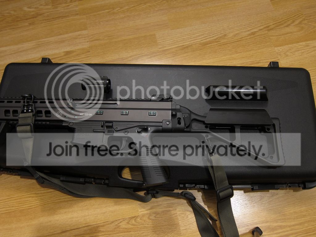

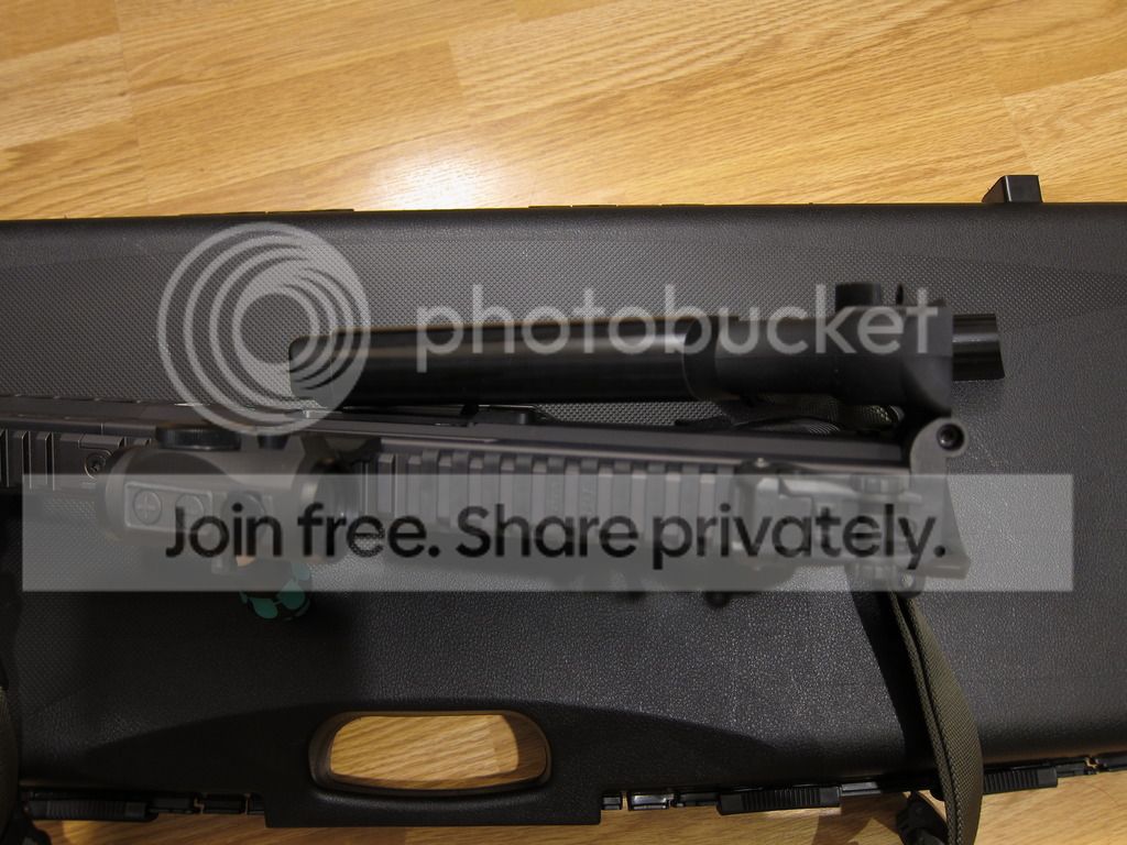

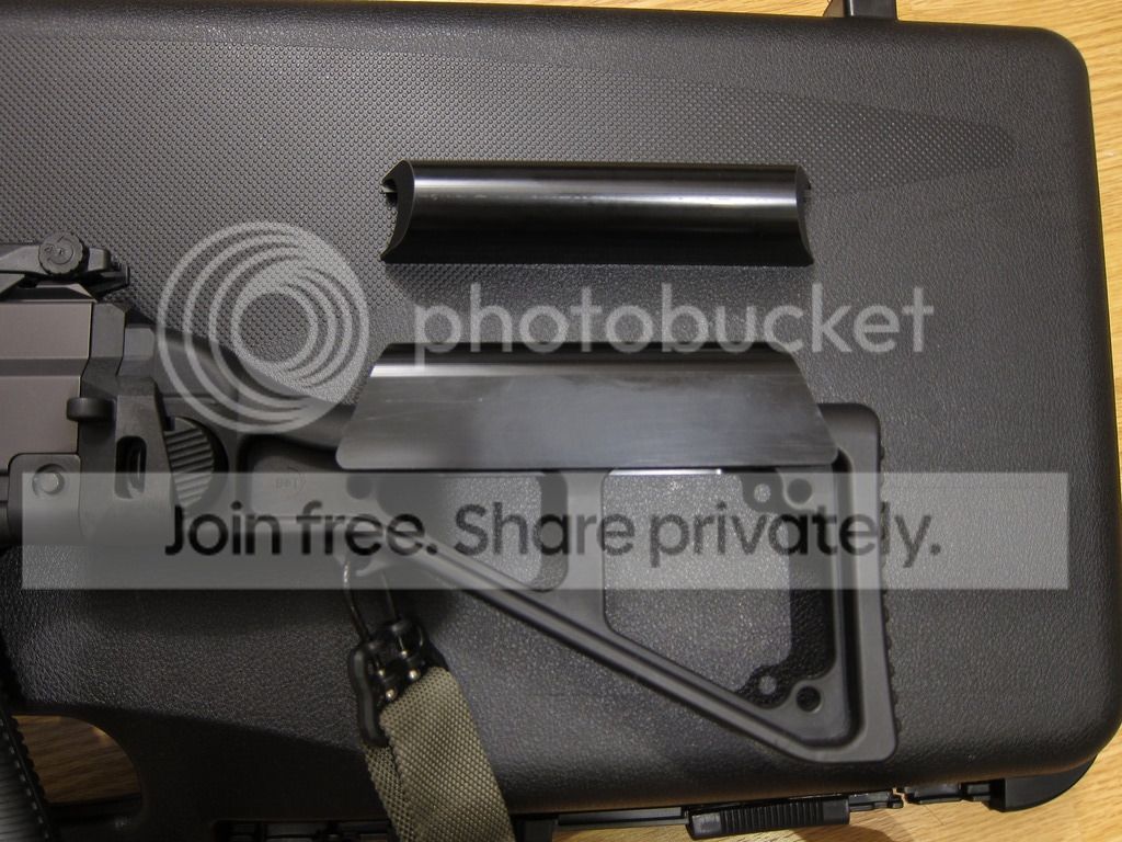

Work finally slowed down enough for me to squeeze a personal project in, so I took the chance to make a cheek riser for my APC223. I made a pair of them, different heights, for what I thought would be the necessary rise for the low folder. (The taller one worked better.) The APC223, being a piston gun, has quite a jump in height-over-bore (1/2"+) over an AR, plus the comb on the APC is lower, relative to the bore, compared to an AR.
I was originally going to make the riser like the SAN one, and connect the riser to the hump near the hinge, but I didn't want to get bogged down in details when I didn't know all the specifics of the required tooling, measurements, the method it would mount, or how I would manufacture it. I went the easier route and profiled a no-snag, ramped style. It's a little short for a traditional, bladed rifle posture; squared up, sitting, and prone seem to be all right.
These ones are made of acetal copolymer, which is what I had on hand. What I had immediately available influenced a lot of the design decisions in this iteration. I think glass-filled nylon would be better, and I'd do a couple of things differently underneath with the mounting, ribs, and whatnot.
It snaps into place and doesn't budge, which I'm happy about.
And you can still fold it.
