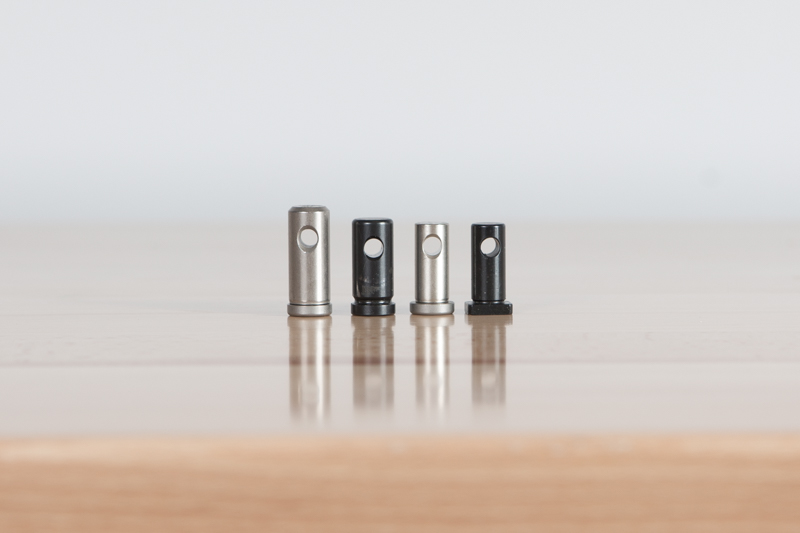

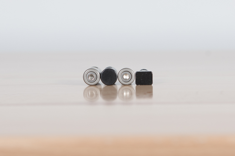

- Cam Pin - No, AR-10 is longer and larger diameter.

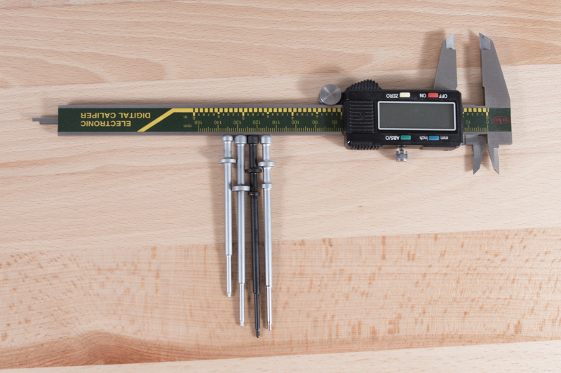

- Firing Pin - No, AR-10 is longer and larger diameter. My AR-10 firing pin also has a spring fixed to it which prevents slam fires.

Pictures of comparisons from the website https://pof-usa.com/revolution-comparison/ :
I know the bolt carrier & bolt head cannot be swapped. Since most people do not swap bolt carrier keys from the bolt carrier, I'm going to ignore them.
(AR15 far right, AR-10 far left https://pof-usa.com/wp-content/uploads/2018/02/IMG_0358.jpg and https://pof-usa.com/wp-content/uploads/2018/02/IMG_0268.jpg)
