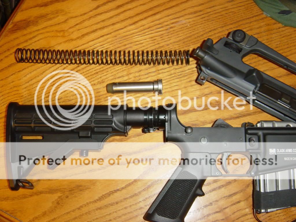

Do you maybe have a rifle buffer installed in a carbine retractable stock, or a rifle buffer spring instead of a shorter carbine spring?
Do you have an SP1 stock installed, but with the longer buttplate screw from an A2 stock?

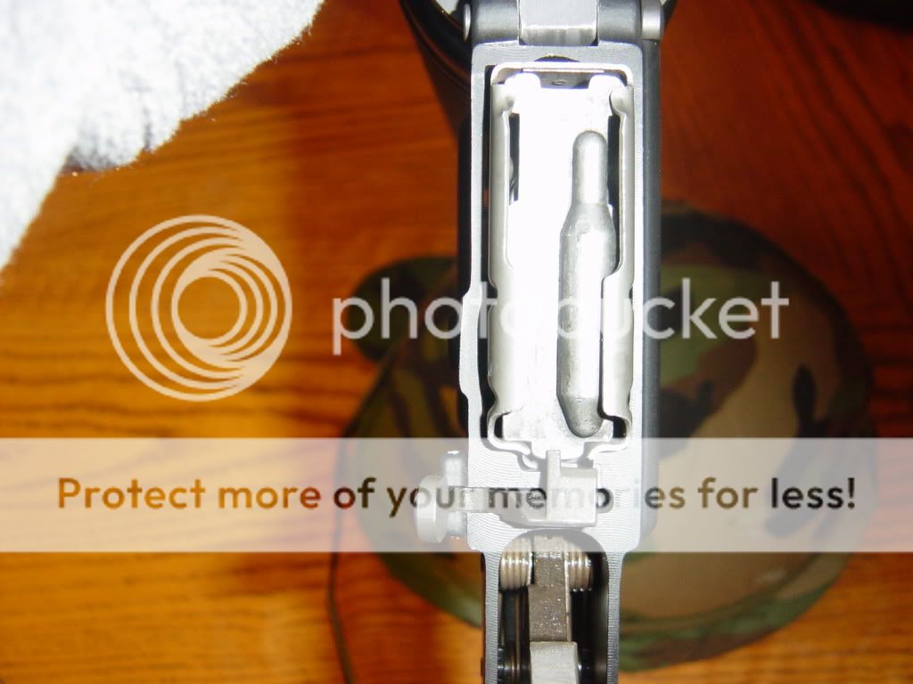

Is it possible for you to take a picture of your lower (the area with the bolt release in particular) and post it?
thanks for the tips guys... cant seem to find any of the problems you guys described.. here's some pics.. sorry for the size..

Being a big PITA here, but could you take one more pic from the side, on an angle? (so we can see the position of the pin/bolt catch).
