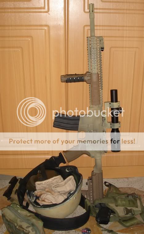

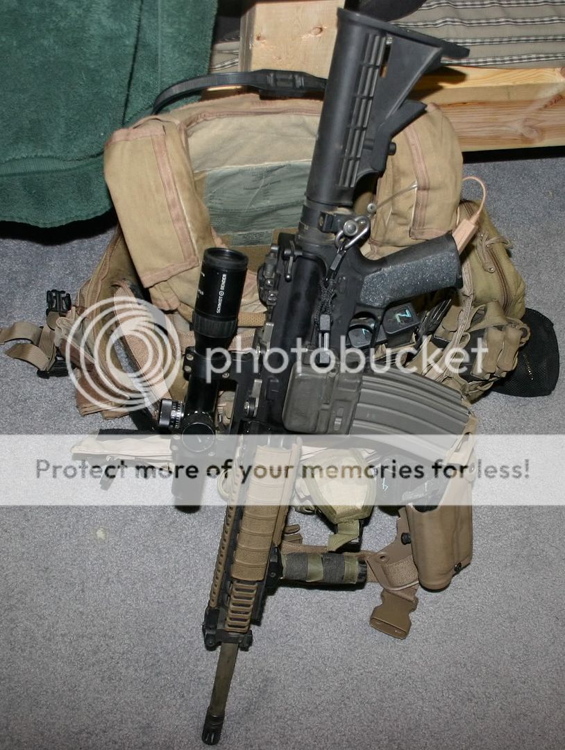

BigRed has a sweet middy Recce
and I am a huge fan of custom middy's
There is nothing wrong with a 16". It reduces the overall lenght to make it more handy and still have a long enough barrel to provide some extra punch. While it does look a little long next to a M4 I still prefer the former.
That's definately NOT a midlength gas system. That's rifle length.
UNLESS, the FSB is just pinned there, and the gas block is actually a low-pro one under the handguards.
