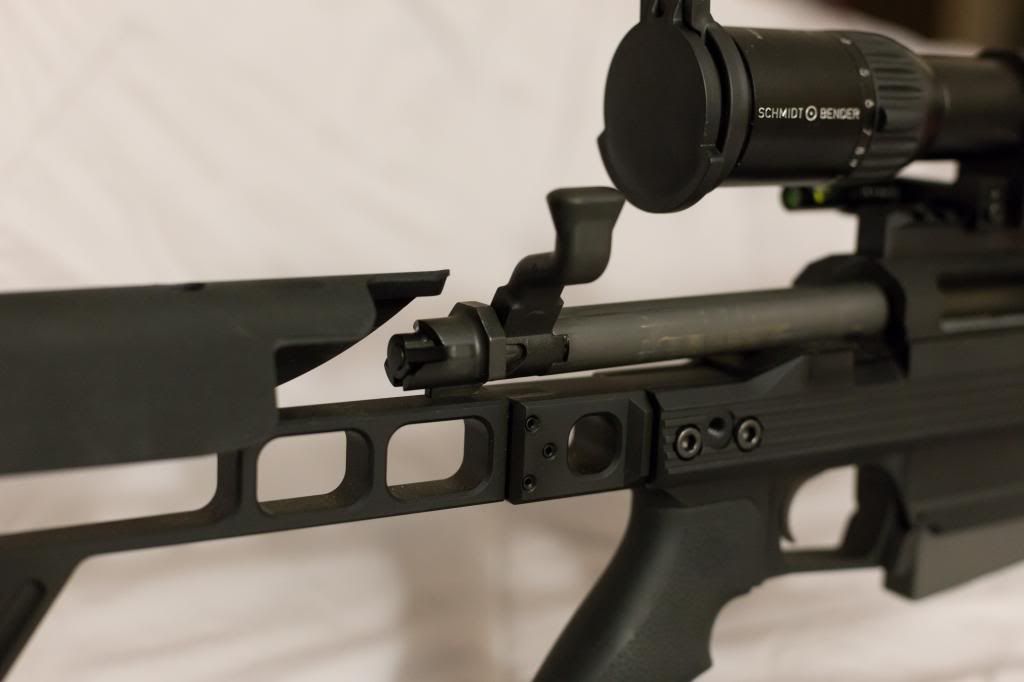

Reliability: Friday's trip to the range was extremely frustrating. Out of 55 rounds I had 14 fail to fire due to light primer strikes. I was cursing the name Armalite and about to call them to arrange for warranty work when I decided to do a little trouble shooting, and realized the embarrassing truth... When I got the rifle (before reading any the the manual, which tends to be something I skip) I had unwittingly loosened the bolt sleeve when I moved the safety lever from safe to fire with the bolt out of battery. After reading the manual carefully and finding the warning paragraph which specifically tells you not to move the safety lever the way I did, it was quick and easy to correct the problem :reface: The loosened bolt sleeve was preventing the striker from achieving full travel... The second trip to the range, today, the rifle functioned flawlessly. Feeding from the magazine is smooth, single shot feeding by dropping a round on top of the empty mag is excellent as well.
