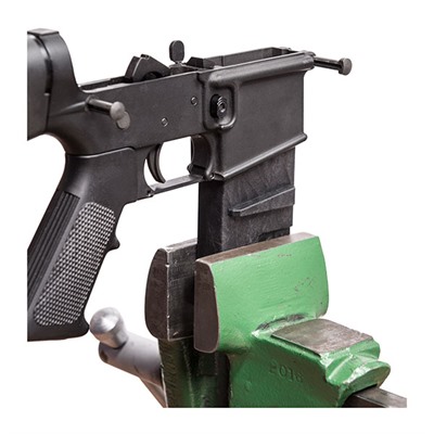

do you have a upper reciever vise block? or are you clamping the barrel in the vise using barrel soft jaws?

I used to use an old style barrel wrench, but last summer I got a Precision Reflex wrench from Brownells part #714-000-007 and I love it. It doesn’t slip and it is rock solid! I use a seperate wrench for buffer tubes.
I also use the blocks that Dsiwy has.
