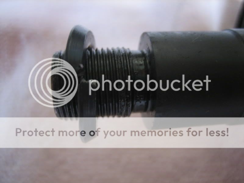

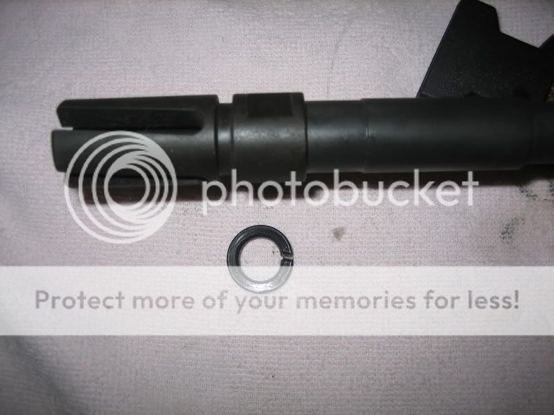

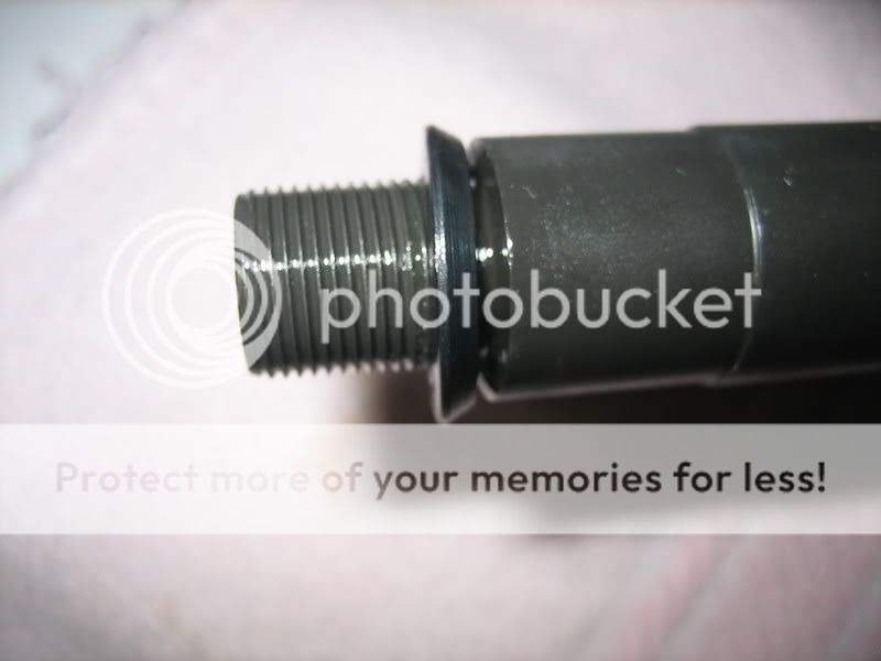

C185 Regular Rating - 100% 4 0 0 May 8, 2007 #1 What is the best way to remove the crush washer, it will not slip past the threads.
m39a2 CGN Ultra frequent flyer Rating - 100% 19 0 0 Location Edmonton Area May 8, 2007 #2 It is soft enough that the threads should cut the way out. Try unscrewing it! Scott
P0WERWAGON CGN Ultra frequent flyer Rating - 100% 72 0 0 Location burnaby BC كافر May 8, 2007 #3 cut it with a sharp side cutter or a dremel. you can also force it onto the threads then unscrew it.
C185 Regular Rating - 100% 4 0 0 May 9, 2007 #4 Mission accomplished with side cutters!! Thank You Last edited: May 9, 2007
