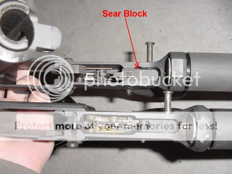

Now, observe this photo:
You can see here the difference in the milling done in the lower receiver for the FCG pocket area for these two semi-auto rifles.
Colt took it one step further, you can see the block that has been inserted (with COLT stamped on it) in the area where the auto-sear would normally go. This also prevents installation of the Full Auto Bolt carrier group with the full-round part on the bottom at the rear.
Here's another variation to prevent installation of an auto sear, or Drop In Auto Sear:
And a different angle of the Colt block:
You can see that the "Through Pin" is located in just about exactly the right area for the Full Auto Disconnector pin hole to be drilled....so if you removed the pin, removed the block, and milled out the FCG to fit an auto-sear (width-wise) you wouldn't have enough meat left in the metal to drill the hole for it's axis pin....
Colt spent a LOT of time and money to make the AR-15 HARD to be converted to anything but semi-automatic, and these changes were why the rifle was able to live on through the bad days....it was clearly recognized by the BATF (ATF at the time) that they might LOOK the part, but most definitely were NOT capable of full auto, and had been carefully modified (hammer, bolt carrier, trigger, firing pin, safety, metal block, pin, non-standard pin sizes, milling machine required, etc) that it was able to easily be proven that due diligence and THEN SOME had been taken by Colt to ensure the rifle was damn near impossible to convert to an illegal full auto.
Many of the newer manufacturers on the market don't put in this block as seen above, the other internal changes are enough to keep multi-letter departments satisfied.
