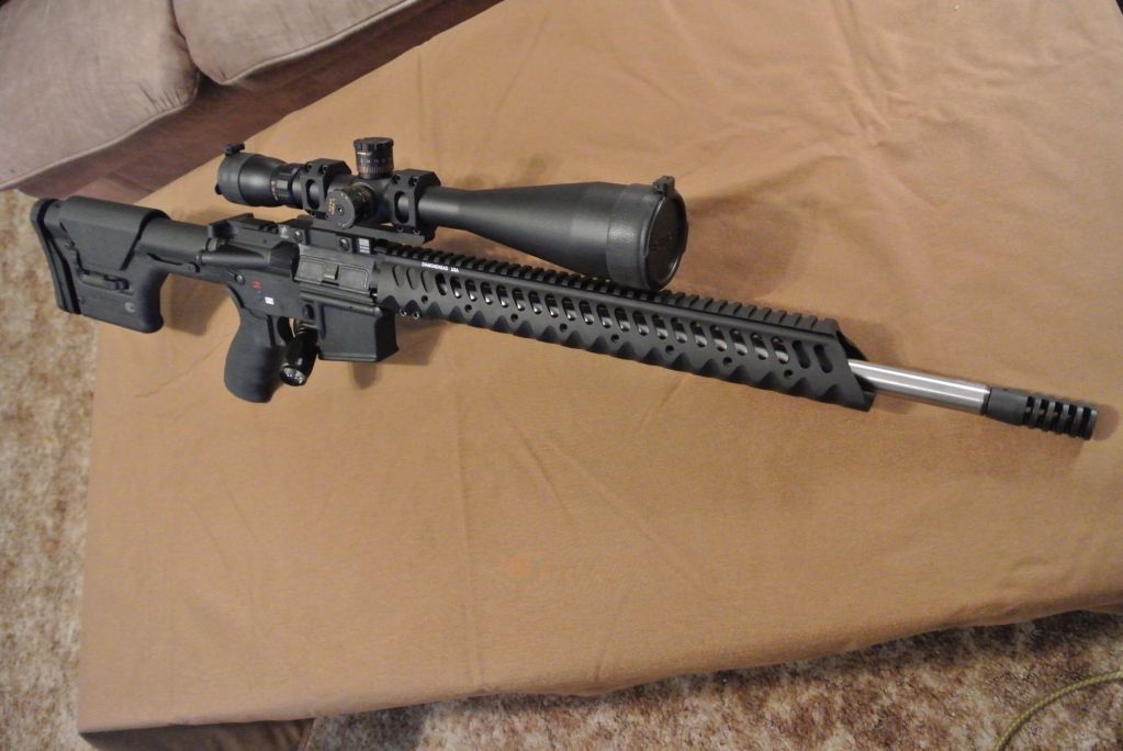

Progressing with the 30 HAR dialing in at 2600+ FPS pushing a 110 grn Hornady projectile.

The 30 HRT/HAR has a 30 deg shoulder and has a 1.570-1.60 case length compared to the 1.50 and 25 deg shoulder of the 30 AR. The 30 HAR is based on the AR 6.8 SPC parent case and borrows the dimensions from the 30/30 cased TC single shot pistol 30 Herrett wildcat.
The optimum projectiles used are the 110-125-130 and for hunting the 150's. The green tipped cartridges in the picture are the 125 grn Noslers which are the most accurate. I have used the 125 Barns X but are very Expensive.
The 20" Jury Custom barrel is a rifle length gas system and functions well with the proper load. However It is sensitive with particular powder charge weights. If I had to do it all over again I would select a mid length like my other 30 AR that is pictured from Tennessee's ARPerformance.com (ARP).

This is based on the AR-15 action using the rifle length gas system. The case uses the new 6.8 x 43 Remington SPC round necked-out to 7.62 mm calibre (and retains the original headstamp). As such, it requires the use of dedicated magazines and bolts. The key advantage the .30 HRT offers over the 6.8 mm is flexibility due to the wide range of .30 calibre bullets available. These range from the 110 grain (7.1g) Hornady V-Max (as shown in the photo; at about 2,700 fps - 820 m/s) up to 240 grain (15.6g) Sierra Hollow Point Boat Tail, loaded to subsonic velocities to rival the specialist .300 AAC.
The 20" Jury Customs barrel has a 1/10 rifling and the 16" ARP barrel is a 1/11.25 5R rifling.

I have a Geissele SSA in my race AR however was looking at and considering the Hiperfire Hipertouch 24c for this rifle. I will investigate more on the suggested HS National Match.
I was asking why not just run a 308 or 6.5/.260 in one of the more modern small frame 308 ar's like the dpms g2 or Daniel defense ?
They are good rifles but still a tad on the large and heavier side. I am a Thompson Contender guy and already have the reloading equipment on hand so it was a smooth transition.
