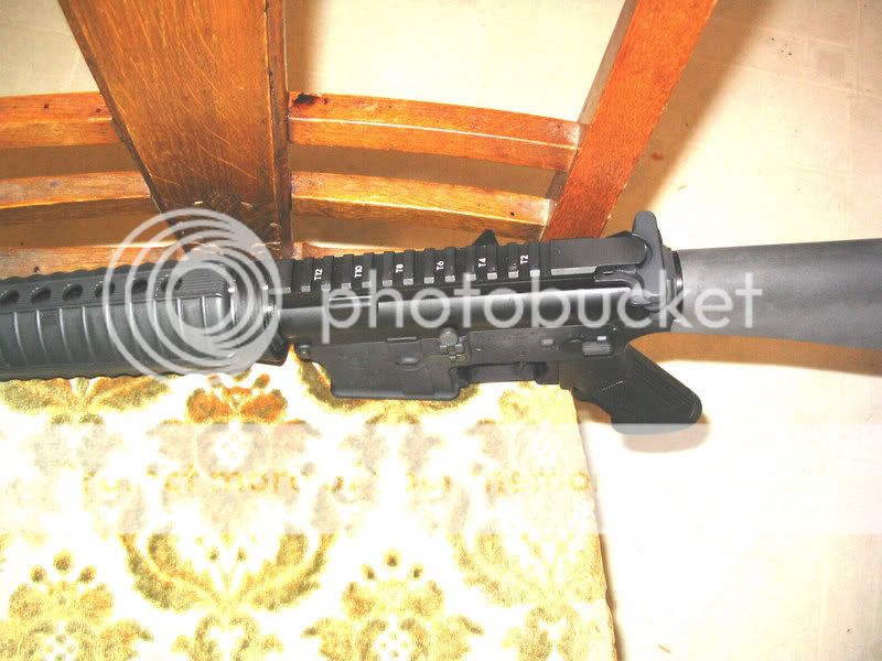

Hello, I just got my first AR which ended up to be a Stag with A2 butt, Gov. profile 20"bbl, 1/9 twist, 5.56 flattop with no handle. Well I thought I would mount a scope that I have lying around here just to see what the picture and feel would be like. I soon realized that the rings I've got are way too low to get a decent weld and still see through the scope. I guess with the A2 stock being on the same plane as the top of the receiver, that it should be obvious. By the time you get a cheek weld, your eye is 2-" 3" inches higher than my scope. What height and type rings do people use? What height riser is common? I'm going to buy the handle down the road and I have a A.R.M.S scope adaptor for that, and I'm just starting to get organized and my wallet is still stinging from the original purchase so a high end scope is way off. Thanks Pete .
Nice rig there!
