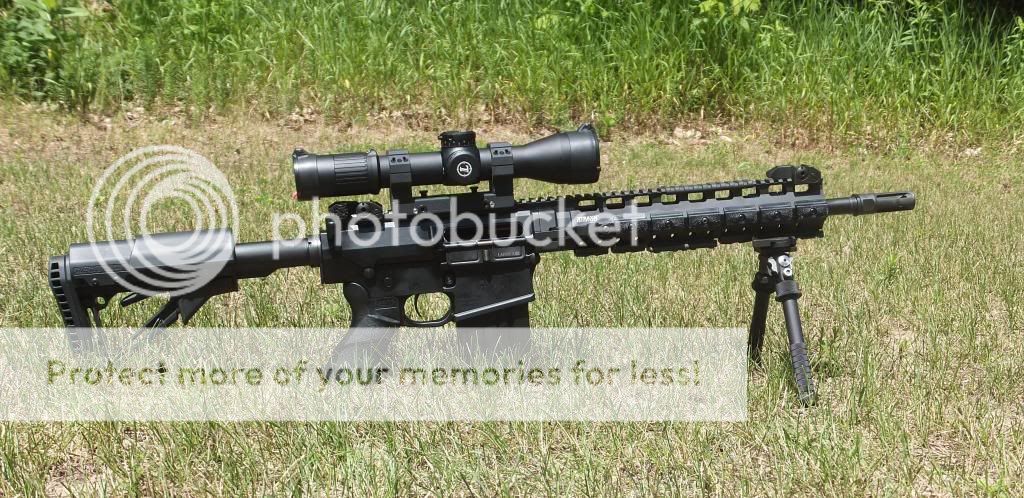

LaRue PredatOBR 7.62 with 14.5 in barrel, consistent 1/2 MOA with either 168/175gr RUAG Match.
