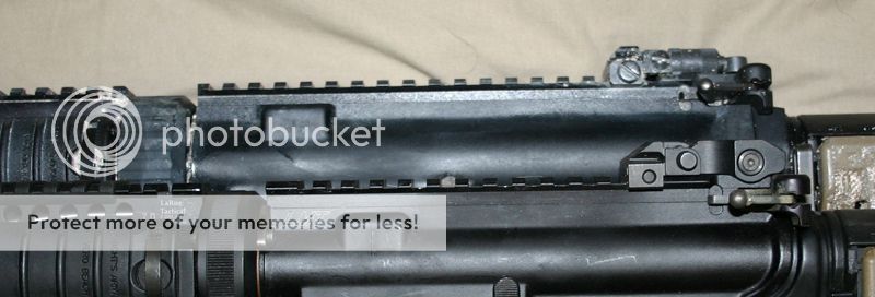

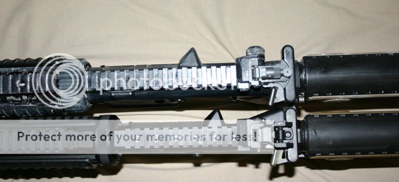

Could some one measure and tell me the difference in length of the AR15 and AR10 uppers? Measuring from the front pivot hole to the very back of the upper receiver would be extremely helpful. Exact dimensions aren't needed, just ball park.
Of course, a few issues may arise. How much difference is there between the AR10 and AR15 uppers? Most importantly, will an AR15 barrel and/or bolt fit in an AR10 upper? I'm hopping the AR10 is just a longer version of the AR15.

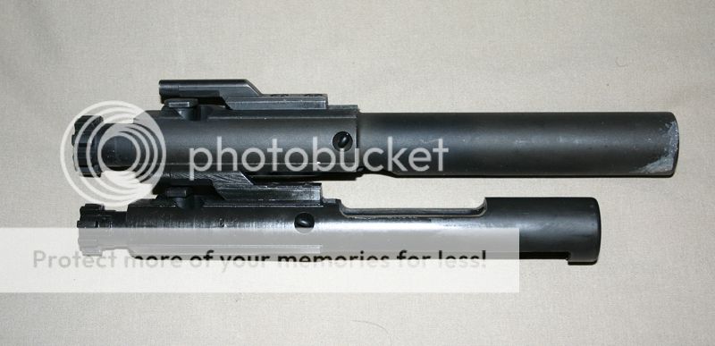

An AR10 will not take a AR15 barrel
- the barrel extension and barrel nuts are different diameters.
You could get a 5.56mm AR10 barrel made if you really wanted - but the bolt is also setup for a larger.

Thanks for the pics Kevin! Looks like the AR10 receiver would be the perfect length but would add more trouble than making a scratch built, out weighing the cost saving possibility.

I would think you could get a stripped AR10 upper off Wolverine. Bead Blast it to remove the annodising and then weld/reweld whatever you want then re-annodize it. However the problem also exists with the Bolt Carrier
I dont think 5.56mm woudl have sufficient energy to cycle it.

I'm not planning to use an AR10 bolt at all. I'm going with the AR18 style bolt system with the short recoil, to keep it an AR180B variant. As such, if I did start with an AR10 upper it would more than likely use a custom bolt carrier, probably be milled out a bit on the inside.
Or maybe cut an AR10 bolt carrier in half and go from there.
