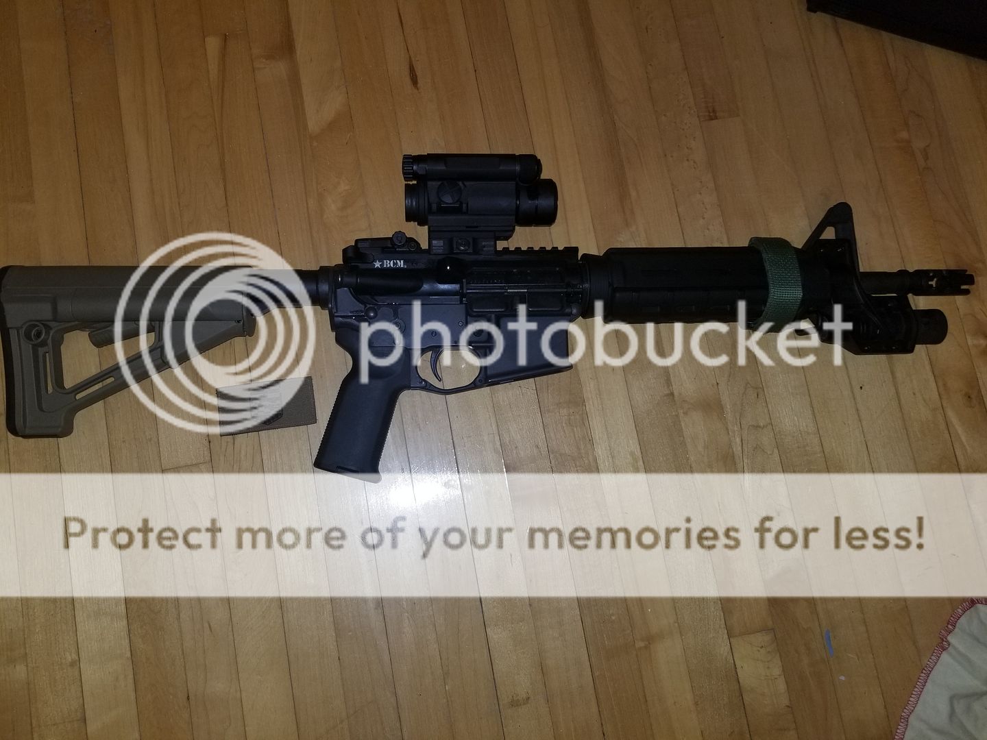

To satisfy the curious I will first go over the setup as is.
Upper is a BCM 11.5 inch FSB upper with a government profile cold hammer forged barrel
Trijicon tritium front post
PWS FSC556 muzzle device
Handguard is a Magpul MOE old style handguard
The strap around the handguard is the zahal narrow velcro sling adapter
Flashlight is an elzetta alpha with a high and low tailcap.
Flashlight mount is an Elzetta mount that would mount most 1 inch flashlights
BCG is all original, Daniel Defense F/A BCG
BCM Gunfighter medium latch charging handle
Rear irons is a Magpul MBUS pro
Optic is an Aimpoint Comp M4 with the killflash on it topped on an absolute cowitness ADM mount.
Lower is a Colt canada SA20 lower.
Geissele G2S installed a few months ago.(approx 400 rounds ago)
Grip is a Mapul K2+
Stock is a Magpul STR.
Optic and Irons zeroed for 100m

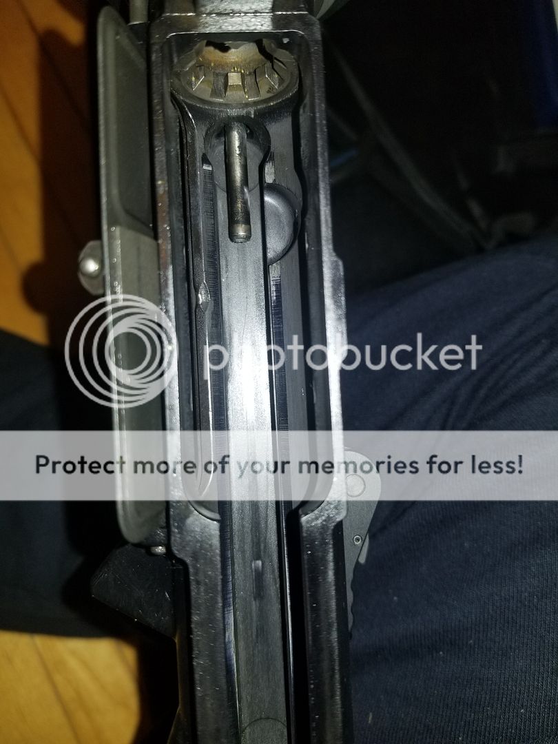

Now let's have a look at the upper receiver itself

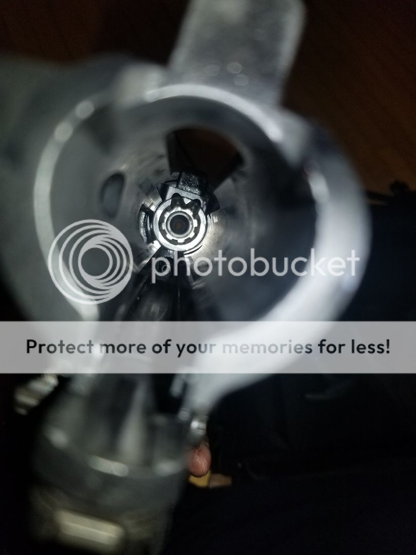

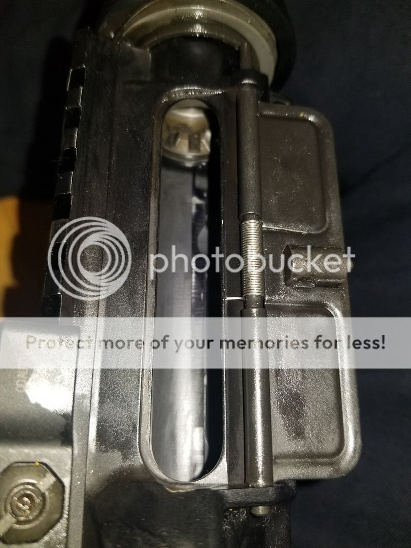

As you can see where the BCG rails ride on the receiver are showing wear as is the area where the cam pin slots in, but the finish isn't completely worn off. The feed ramps look good, and while I couldn't get any pictures to come out good for the rifling, it honestly still looks new chamber and bore, obviously headspace check went good. I did not borescope the gas port for wear(mainly because I don't have access to one atm) but for the 10k whenever that happens I'll try to source one.

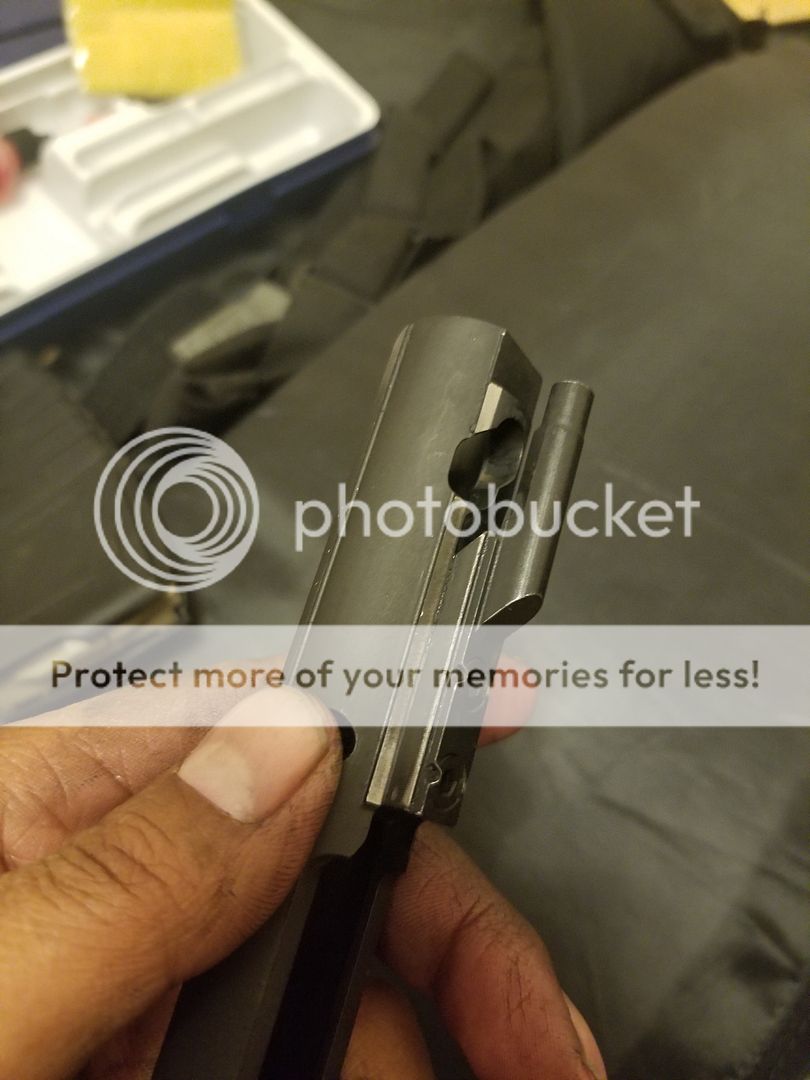

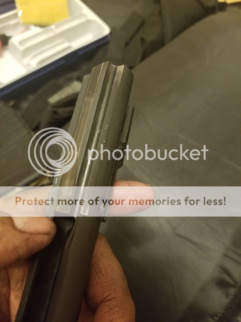

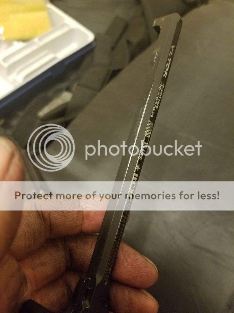

Up next we'll look at the BCG itself.

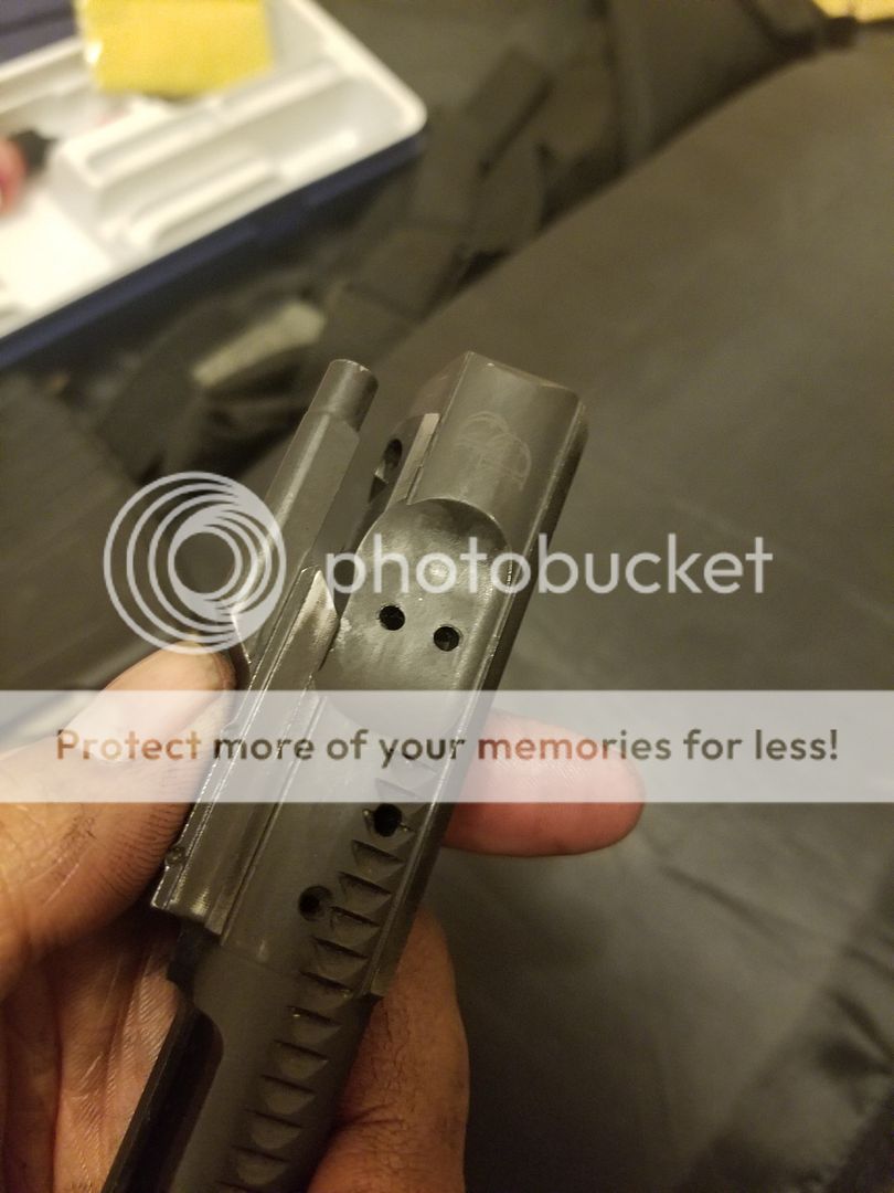

The BCG also has some wear on the rails, and on the gas key itself. There is a visible wear to the front face but it feels quite smooth.

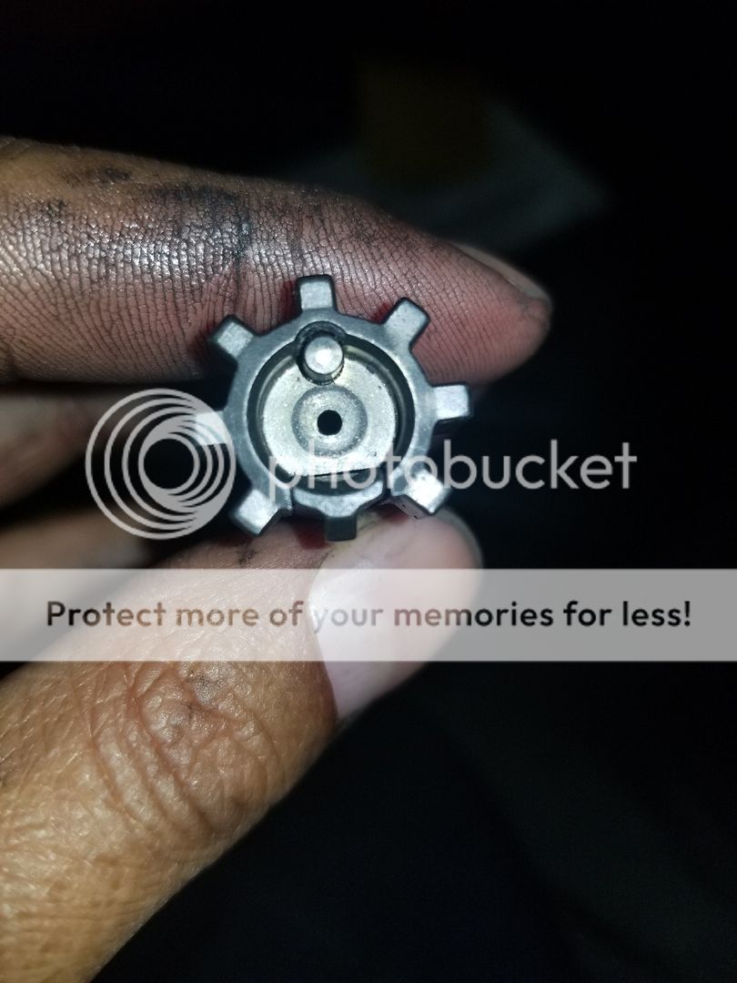

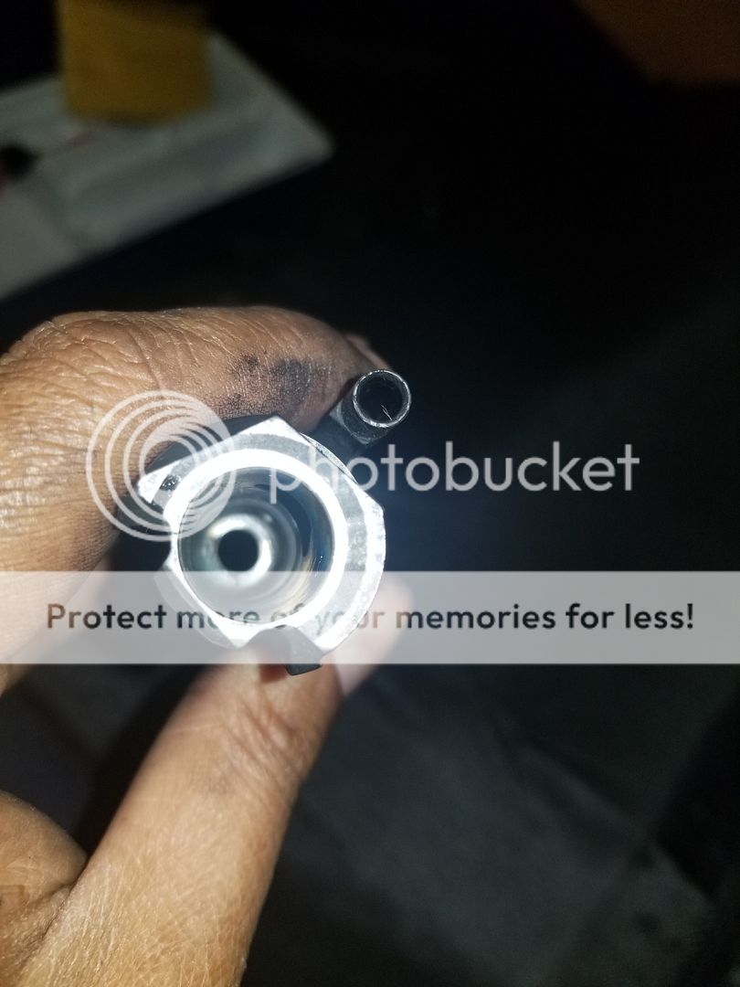

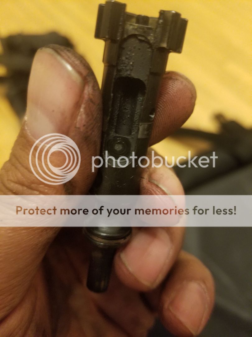

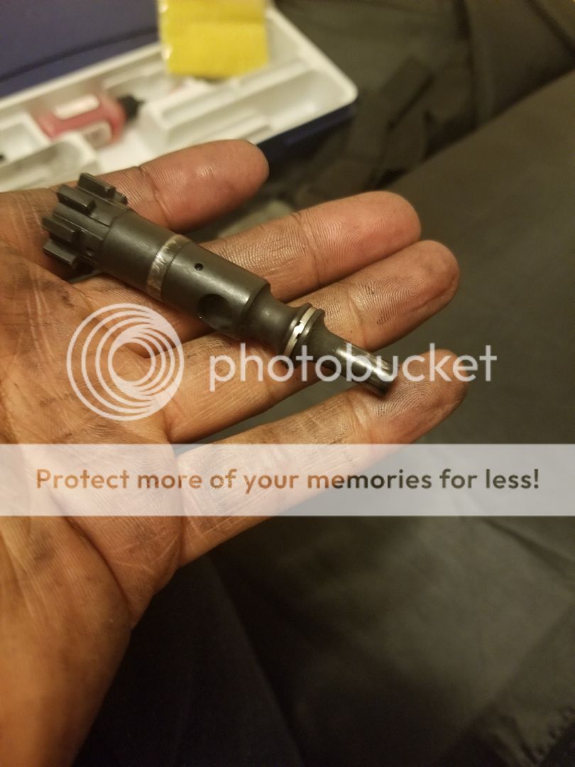

Up next we'll look at the bolt itself I wanted to take one quick picture of how much gunk gets into the firing pin channel under the extractor for those that never clean it. Personally I don't clean it on ever time i take this carbine down but usually get the extractor off every 1500-2000 rounds... do what you will with that as a reference guide.
Bolt face itself has some wear off the face on the lugs. The back end of the lug is mostly good with a very small amount of finish coming off. No visible cracks found at the back of the lugs or at the cam pin hole. Bolt will be run till it breaks.

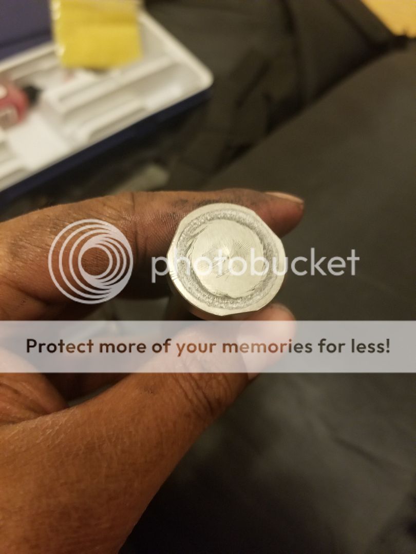

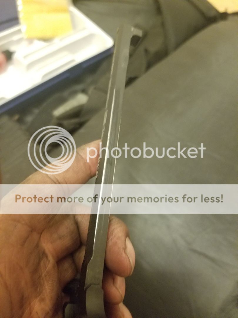

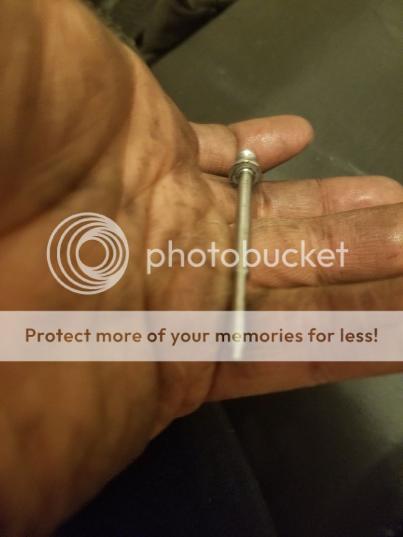

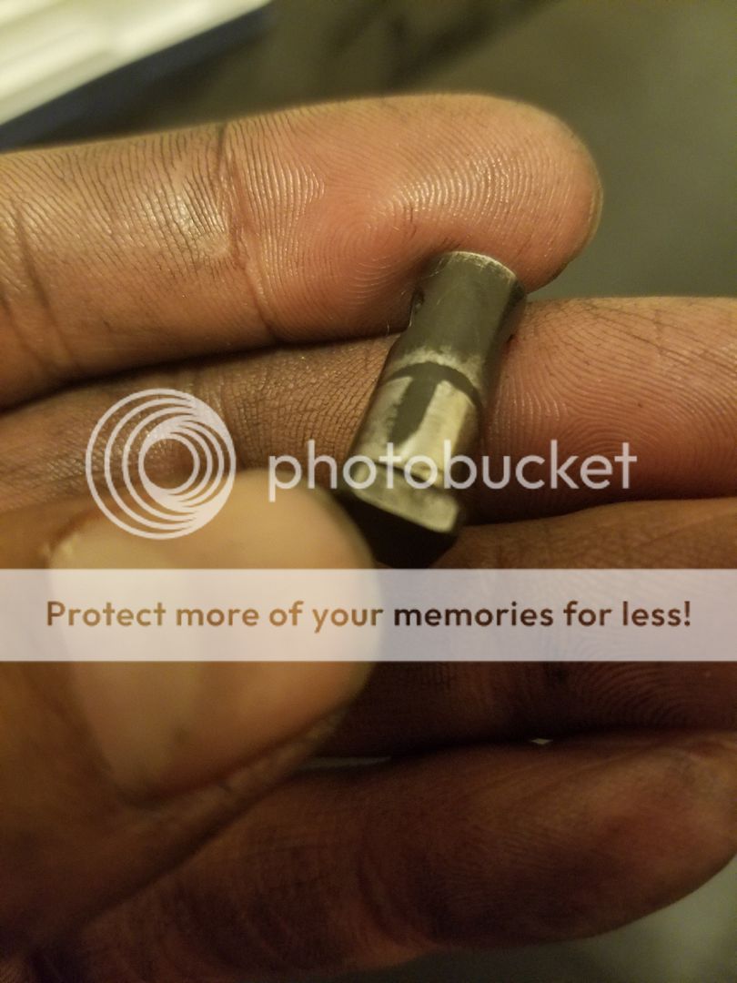

Now moving on to some other small parts such as the firing pin, the cam pin, the buffer, and the charging handle
You can see the wear spots by where the finish wore off on the charging handle. you can easily feel the wear line on the cam pin, and the firing pin looks new minus the carbon ring on the shoulder. Buffer has visible wear but the spring measured within servicable limits so it will be continued.

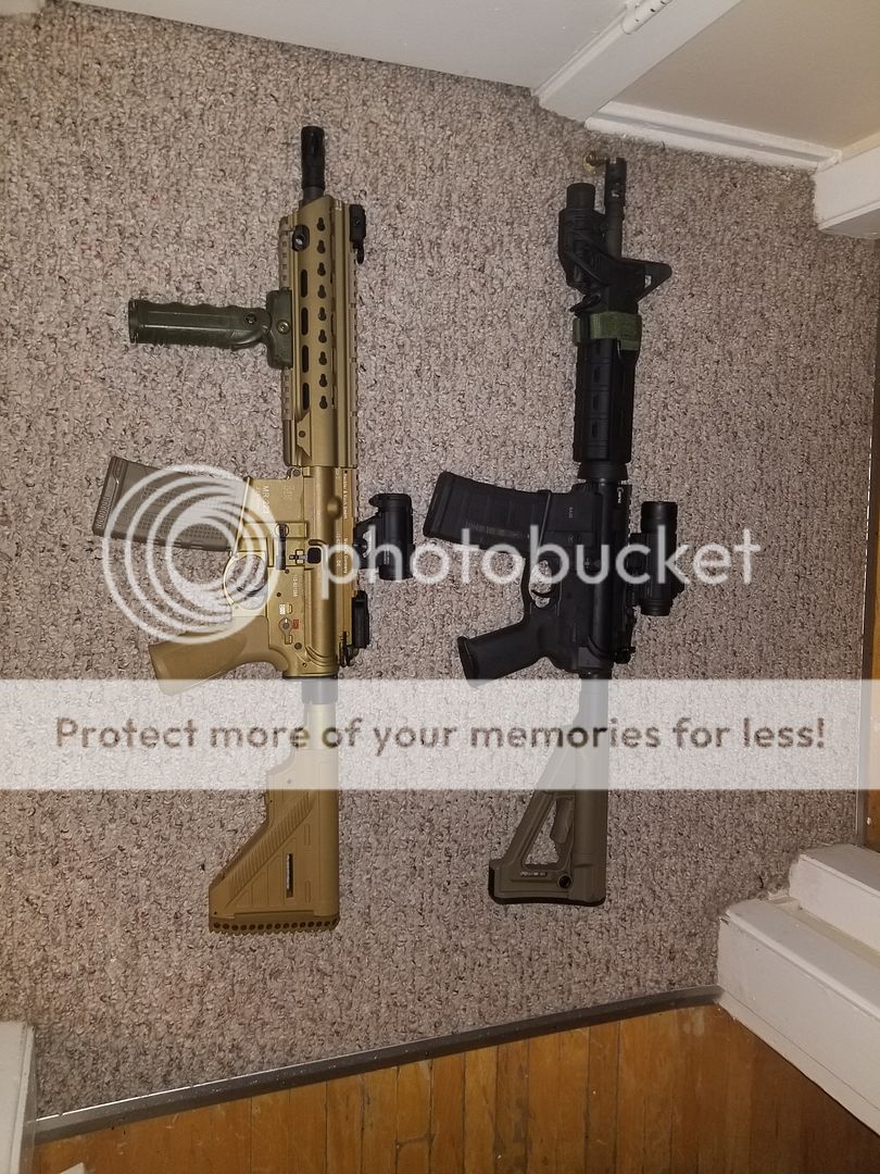

This did show up very recently
oh, so now they offer MR223s in gold instead of RAL 8000 eh? lol
Due to our magazine limits, our schedule of firing is probably very low relatively to what the rifles can do, so even less wear there.
I'll probably reach 5000 in my MR223 before you. I'll post something at that time. I dont plan on cleaning my piston for the next 2-3 thousand rounds. So we'll see what happens.
Entirely possible since I will shoot the mr223 but due to ease of parts access will conduct the majority of training and practice with this ar. Odds are this will hit 10k before the mr hits 5k but I look forward to reading your report.
