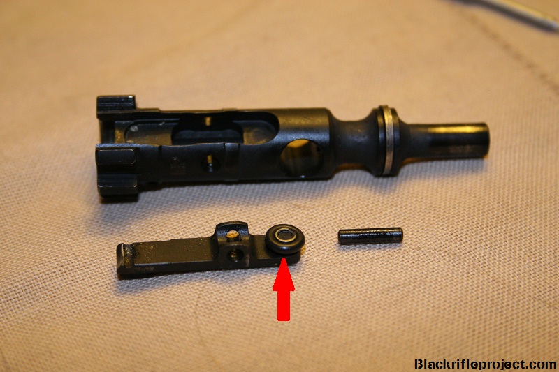

1. Broken, damaged or fouled extractor hook. Disassemble your BCG and remove the extractor from the bolt and examine it. If it is worn/broken, then just replace it.
2. System over-gassed and not enough tension on the extractor. If your extractor only has the rubber plug and spring then pick up an upgrade kit for your extractor or just the o-ring. I believe it's a #60 Viton o-ring if you can find them.

No O ring on the extractor, it's just a bare spring. What's the purpose of the o ring?

get the bcm improved extrator spring kit, its like less than 10 bucks.
get an RRA extractor, they are pretty heavy duty

be carefull with the RRA extractor and the bcm upgrade spring kit, if you shoot cheap low quality ammo, it has a chance to rip the casing rim and then you have a bigger serious problem, shoot good ammo.
you'll need a vice grip with soft covers or a table vice with a set of wood shims to get the upgraded BCM spring installed, yes, it is that hard of a spring with the o ring.

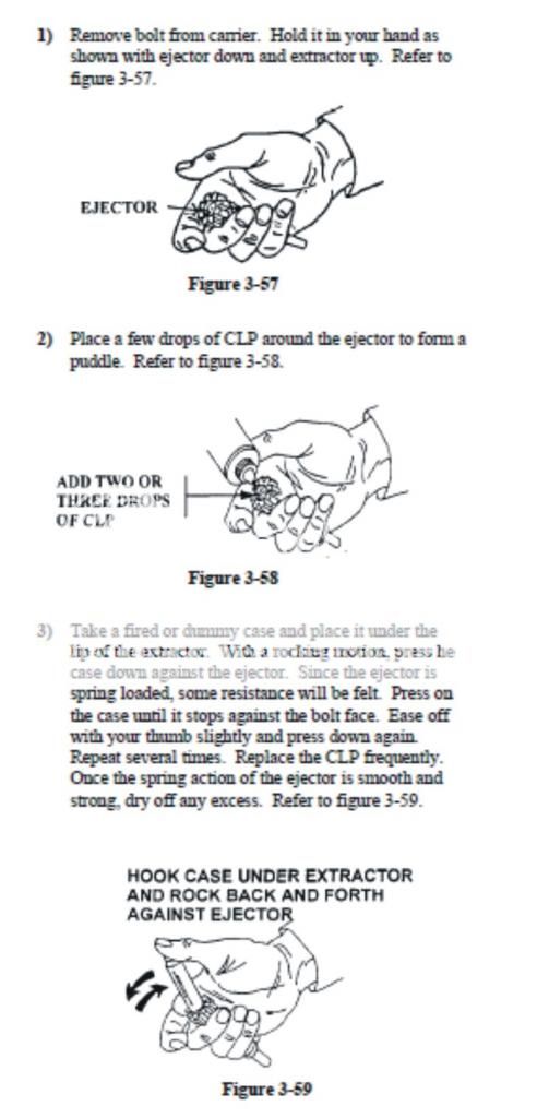

Also, as an after though, you said when you poke the ejector it goes in and out. how much force does it take you to compress your ejector? All my ejectors have required quite a bit of force to depress. Not impossible to do, but not easy by any means. If you can easily just push the ejector in like its nothing, it might not be putting enough force on the case to eject it properly.
Borrowed from google, an image on how to test the ejector spring
