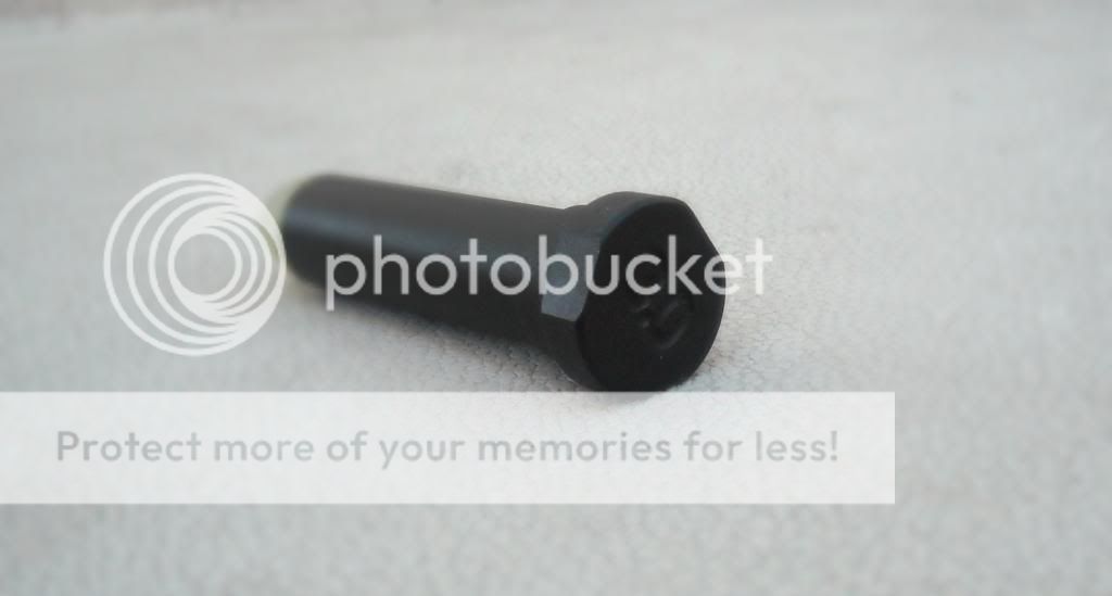

We will be offering AR15 Carbine heavy buffers very soon.
As with all of our products we have been doing months and months of testing and feel we are ready to bring these to market.
we are just waiting on a shipment of carbide then we will finish the first production batch and get them out to our dealers
Specs
CNC machined 6061 T6 heat treated
Mil spec Hard anodized finish
100% made in Canada
AR15 carbine buffer weight is a fundamental part of thecycling operation of any AR15 carbine.
In general terms, the shorter the barrel the heaver thebuffer that is used.
But with many people doing custom builds, as well as barrel gasports having a wide range it is common for guns to be over gassed or undergassed.
Another issue is if you are shooting standard load 223 Remingtonor full NATO load .556x45 ammo.
We are offering 3 weights
3.0 .Oz
4.0 .Oz
5.0 .Oz
