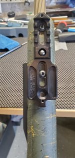

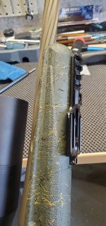

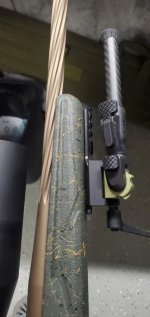

I put on a Salmon River Solutions combo unit on mine. Works very nice.
