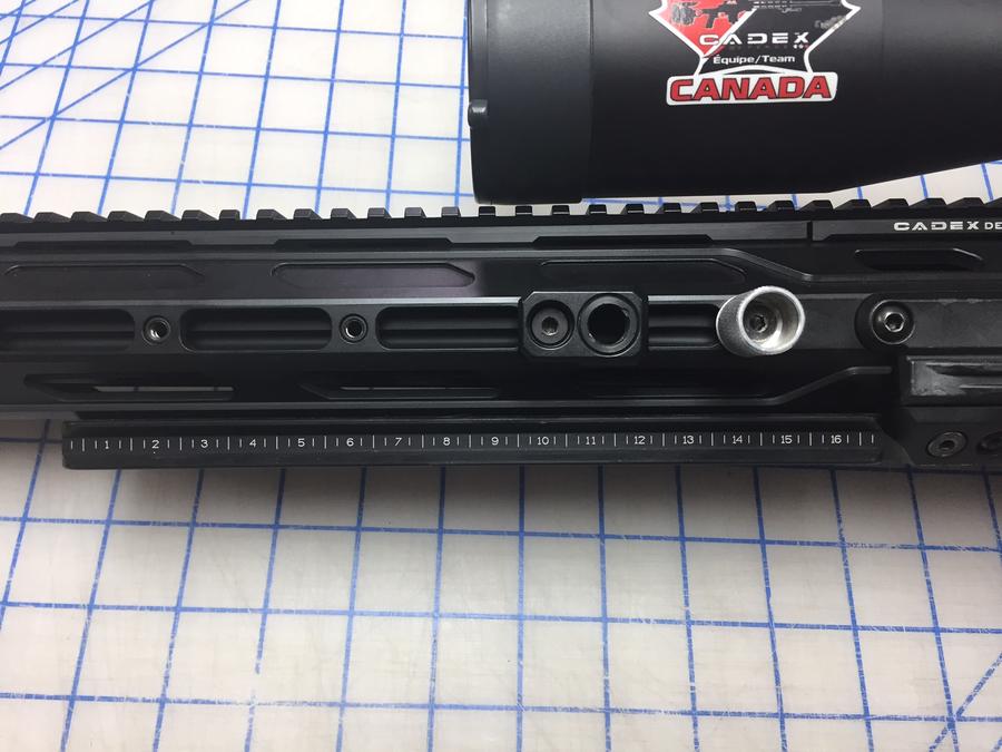

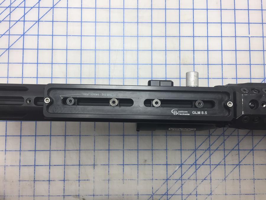

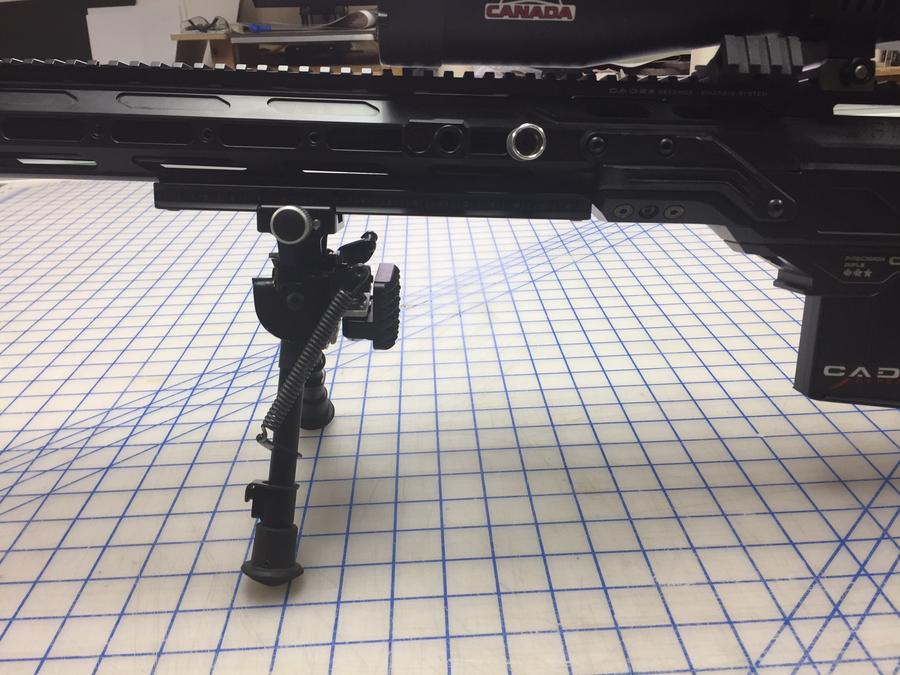

I am mounting an Area 419 12 inch Universal Arca rail adapter plate that I got from Go Big Tactical on my Rem 700 (308) Cadex Field Strike chassis
I had to drill a hole in my chassis for the rear most mounting screw and I also had to cut 2 3/4 in from the rear of the plate as it stuck out to far past the end of the forestock. It is now 9 3/8 inches but I should have cut it to 9.5 in long .The plate is supposed to be attached at the rear of the plate using the rear mounting bolt for the receiver. That wont work on a Cadex chassis so the plate had to be cut shorter . I can use 3 factory screw mounting locations and 3 of the supplied allen bolts from the Tnuts I am not using as they are the same thread pitch ( 10-32 ).They need to be cut shorter is all. There is one T nut and allen bolt used for the hole I drilled in the forestock near the rear of the plate to mount it. I flattened the 3 tabs on the one Tnut I used in a vice so it would sit flush inside the stock
Pics are after cutting the plate shorter and the screw in the pic will need to be filed down on the sides to be able to be countersunk.
