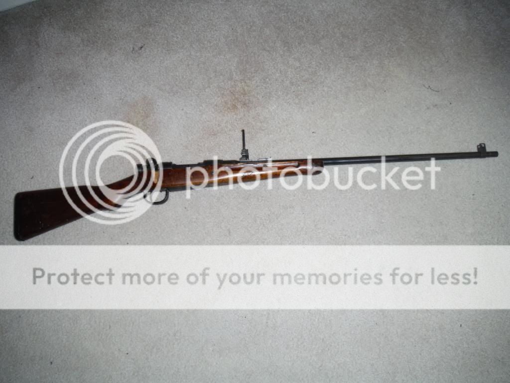

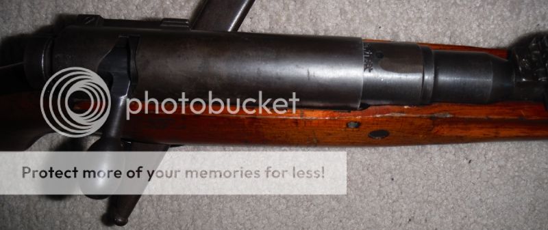

Here is how I received the rifle

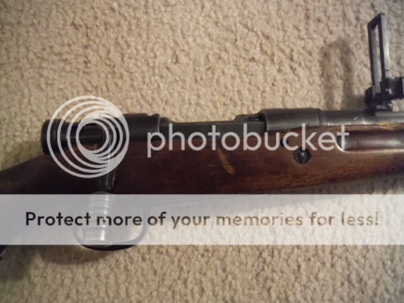

And here it is with the bolt I acquired for it. I am still debating wither to try and find gun smith to cut off the bolt handle from this and install it on the other bolt as the other bolt is in much better condition.

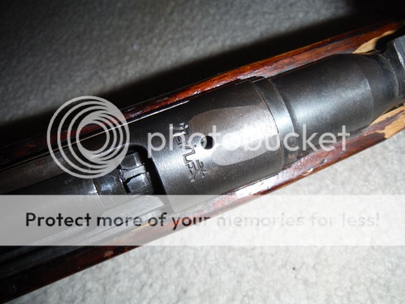

Just to add to the info I found out the rifle I have is from the first series (as in the zero series) from Nagoya as there is no circle with the kana on it which means it was within the first 100000 manufactured there. That I think places production sometime between 1939 and 1940 (serial number is 563xx). Any help is appreciated.

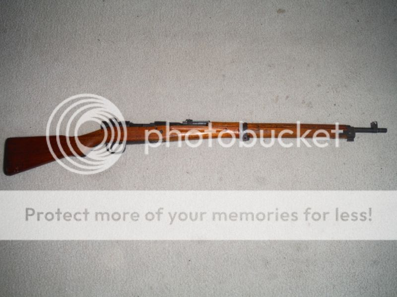

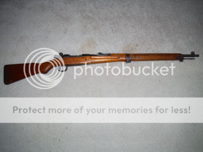

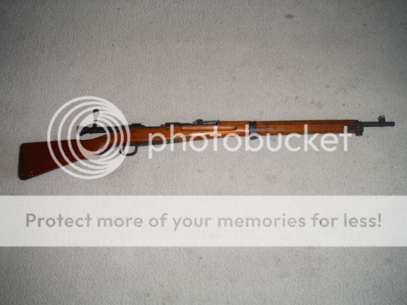

Here is some pictures of it restocked.
I consider this restored just not to factory standard, as all I need is the monopod, anti-aircraft sights, and dust cover.

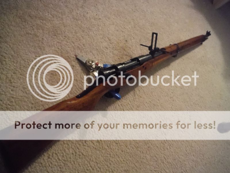

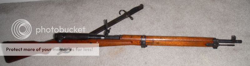

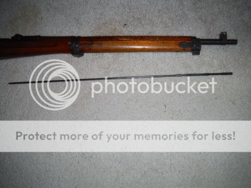

Well those parts I ordered came in. Heres what she looks like now.
Here is an original cleaning rod (no repros on this restoration)

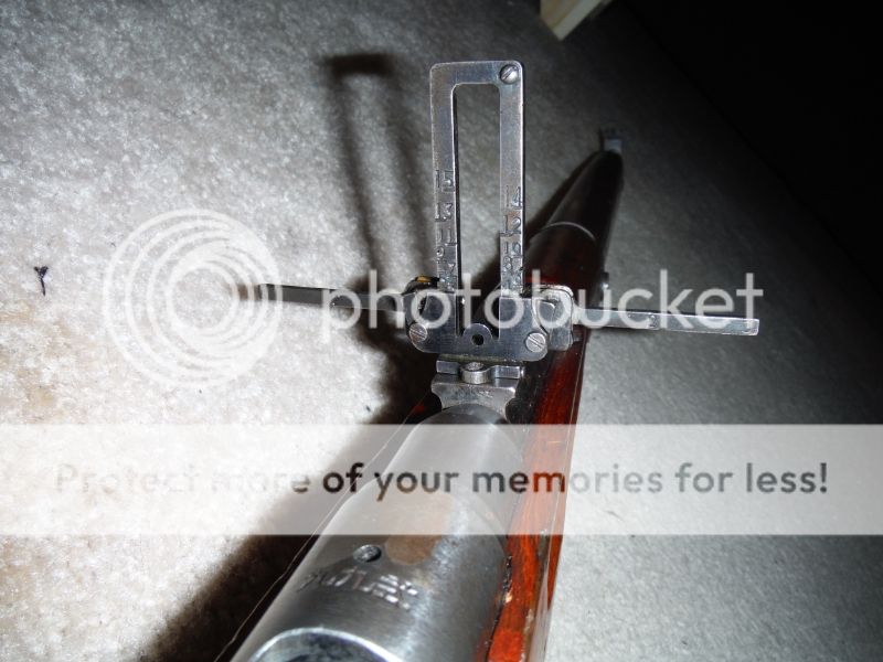

Here is the AA-sights not bad looking
The AA-sights were manufactured by Nagoya as well so it works with the rifle

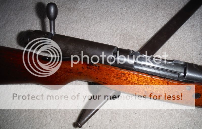

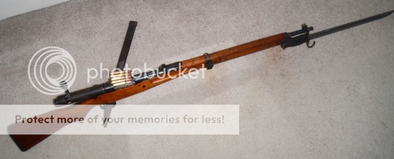

Hi all,

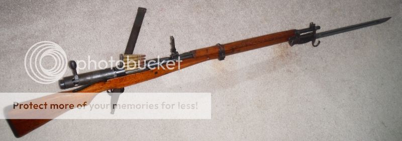

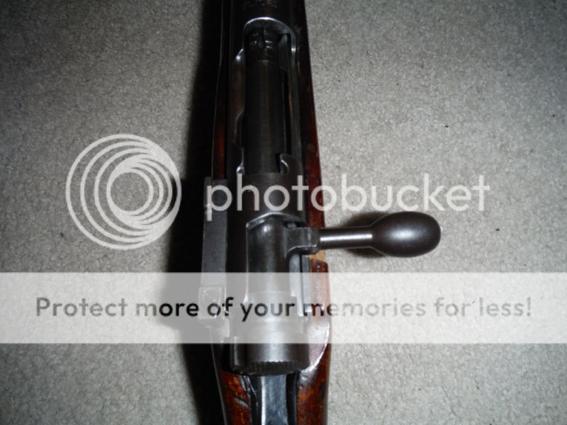

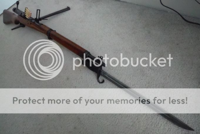

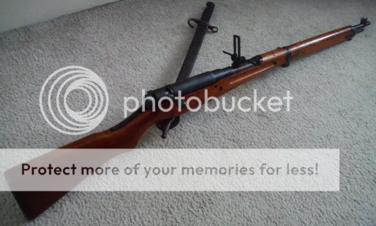

Original dust cover arrived along with a nice Type 30 bayonet (manufactured at Toyoda Jidoshoki Seisakusho (Toyoda Automatic Loom Works) under Nagoya supervision). I also had the bolt handle cut off the one bolt and welded on the original one (the one that had been turned down) as the other bolt was in some rough shape (wouldn't feed the brass and to fix it wouldn't have been worth while). The work on it was so well done that if you didn't know it had been welded you wouldn't be able to tell (besides the lack of bluing on the one part). The restoration is almost complete, only missing the monopod and once I find one it the rifle shall be back to factory configuration (excluding the ground chrysanthemum). I have to say the action is one of the best I have ever worked (nice and smooth) and if it is accurate as well then I definitely have a keeper. The gun just seems well balanced and really well thought out, not to big to be clumsy, and it is fairly light. Well here are some pics of it at the moment, can't wait to get it out to the range!
