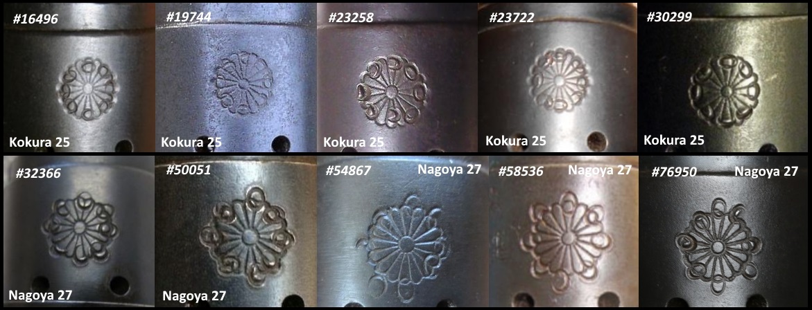

I was under the impression a batch of type 38 Kokura serie 25 was given to thailand (beginning of 1940??) by Japan and were gently defaced with Japanese Circles. I have one all matching (with matching dust cover) with that light defacing. I am pretty sure it ia a serie 25 Kokura too.
i think they used them against colonial french army in the Cochinchina area
Edit:
After a fast google search, it look like Japan sent some type 38 from Kokura and Nagoya 25th and 27th series to thailand in 1940 (20 000 to 25 000???). They were designed Type 83 by the thai. They have light defacing on mum probably made by Japan in 1940

Hard to say i am not an expert on arisaka and bought mine about 10 years ago. The stock being being refinished is a shame, but the 2 pieces buttstock is normal on japanese rifles. We can see quite often the thai type 83 in canada as a batch has been imported in canada, but people rarely think about the thai connection and most sell as normal type 38. I dont think being a type 83 will bring more in Canada despite being a rare contract. In USA, there is some thai or japanese collectors looking for type 83 to complete a collection. Arisaka are not too common in general in Canada and they bring more and more.
Here is a picture about the type 83 defacing i found on another site (it is not mine it is from French collector Laurent Valez who studied them when imported in europe). The pattern is not too standardized, but always 8 circles. Japan had a similar defacing on mum for rifles used in training
