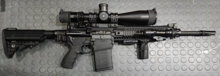

Here's my Arken EP5 Gen2, 7-35x 56mm mounted on my Colt USA LE-901:
